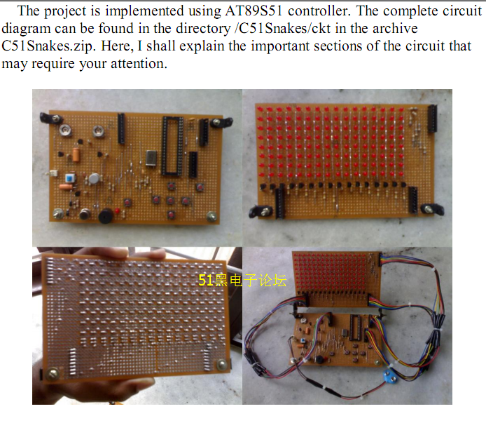

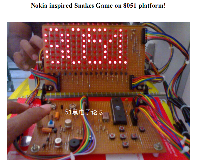

网上看到的一个贪吃蛇的文件,用的是16x8的点阵。
实物图:

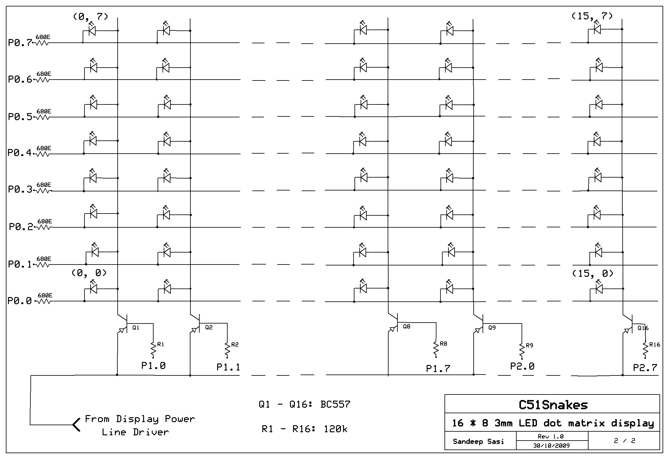

电路原理图如下:

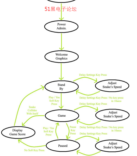

16x8led点阵程序流程图:

  35. $INCLUDE (PauseState.inc)       ; Functions that are called when the game is paused
  36. ORG 0801H ; The core game library functions; Beginning of page two of ROM
  37. $INCLUDE (EggHandle.inc)        ; Functions to handle generation and management of eggs for the snake
  38. $INCLUDE (GameBackEnd.inc)      ; Functions that not directly called from the Main block
  39.                                 ; The core game logic is handled by these functions
  40. $INCLUDE (GameFrontEnd.inc)     ; Functions that are called from Main block to notify various states of the game
  41. ; Beginning of the Main Block
  42. C51Main:
  43. GameStandBy:
  44.                                 LCALL _StandBy ; Enter stand by
  45. GameInit:
  46.                                 ACALL _NotifyGameBegin ; Initiate the operations before game begins
  47.                                 LCALL _WaitForAllActionKeyRelease
  48.                                 MOV PREV_KEY_STATES, #ALL_KEYS_PRESSED ; Force the user to release all keys
  49.                                                                        ; to start processing them in the polling loop
  50.                                 LCALL _ResetSystemIdleTime
  51. GameRun:
  52.                                 MOV CURR_KEY_STATES, KEYPAD_ACCESS_PORT ; Sample the state of all keys
  53. TestForAnyKeyPress:
  54.                                 MOV A, #ANY_KEY_MASK
  55.                                 LCALL ADetectedDepressedStateOfKeyMaskInA
  56.                                 JNZ BeginKeyScan ; If a key press is detected, start scanning the keys sequentially
  57.                                 LCALL AStepSystemIdleTimeAndNotifyOnExpiry ; If not, advance that system idle time
  58.                                 JZ EndOfKeyScan         ; If system idle period expires,
  59.                                 ACALL _NotifyGameFreeze ; then freeze the game and
  60.                                 LCALL _PowerDownSystem  ; initiate system power down
  61.                                 ACALL _NotifyGameRestore ; Recover game from power down state
  62.                                 LCALL _WaitForAnyKeyPress ; Wait for a user event
  63.                                 MOV CURR_KEY_STATES, #ALL_KEYS_PRESSED
  64.                                 SJMP EndOfKeyScan
  65. BeginKeyScan:
  66.                                 LCALL _ResetSystemIdleTime
  67. ScanGamePauseKey:
  68.                                 MOV A, #PAUSE_KEY_MASK
  69.                                 LCALL ADetectedDepressingEdgeOfKeyMaskInA ; Check whether the pause key is hit
  70.                                 JZ ScanDelaySettingsKey ; If not, check the state of Delay Settings key
  71.                                 ACALL _NotifyGameFreeze ; If yes, initiate a game freeze
  72.                                 LCALL AGamePause ; Enter paused state
  73.                                 JZ GameEnd; If the user wishes to quit, end the game and
  74.                                           ; display the game score
  75.                                 ACALL _NotifyGameRestore ; Else, initiate game resume
  76.                                 LCALL _WaitForAnyKeyPress ; After restoring the display to the state when the user
  77.                                                           ; hit the pause key, wait for a user event
  78.                                 MOV CURR_KEY_STATES, #ALL_KEYS_PRESSED
  79.                                 SJMP EndOfKeyScan ; Perform no more key processing in this iteration
  80. ScanDelaySettingsKey:
  81.                                 MOV A, #DEL_SET_KEY_MASK
  82.                                 LCALL ADetectedDepressingEdgeOfKeyMaskInA ; Check whether the pause key is hit
  83.                                 JZ ScanGameActionKeys ; If not, check the state of Game Action Keys
  84.                                 ACALL _NotifyGameFreeze ; If yes, initiate a game freeze
  85.                                 LCALL _DelaySettings ; Enter the mode that helps the user to adjust the snake's speed
  86.                                 ACALL _NotifyGameRestore ; Restore the game once the user has switched back to game mode
  87.                                 LCALL _WaitForAnyKeyPress ; After restoring the display to the state when the user
  88.                                                           ; hit the pause key, wait for a user event
  89.                                 MOV CURR_KEY_STATES, #ALL_KEYS_PRESSED
  90.                                 SJMP EndOfKeyScan ; Perform no more key processing in this iteration
  91. ScanGameActionKeys:
  92.                                 ACALL _ScanGameActionKeys
  93. EndOfKeyScan:
  94.                                 MOV PREV_KEY_STATES, CURR_KEY_STATES ; Init. PREV_KEY_STATES before next round of processing
  95.                                 MOV A, #GAME_TIME_STEP_PERIOD
  96.                                 LCALL _DelayABy100ms
  97.                                 ACALL ANotifyGameTimeStep ; Initiate a change of game state
  98.                                 JZ GameOver ; Collision detected; So, game over!
  99.                                 SJMP GameRun ; Loop around to Game Block
  100. GameOver:
  101.                                 ACALL _EndOfGameGfx ; Alert user about end of the game
  102. GameEnd:
  103.                                 ACALL _NotifyGameEnd
  104.                                 ACALL _DisplayGameScore
  105.                                 SJMP C51Main ; Loop around to Main Block
  106. END ; End of app.

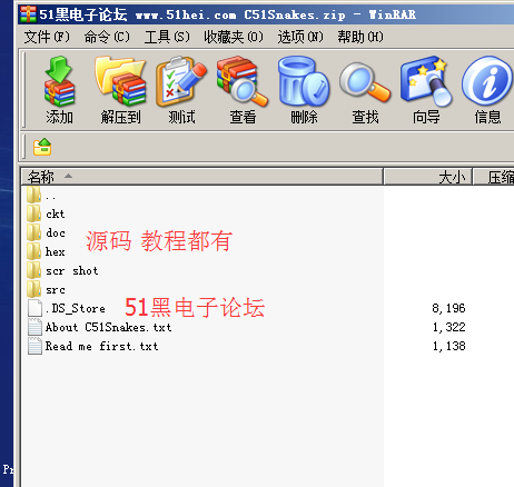

所有资料51hei提供下载:
C51Snakes.zip (2.18 MB, 下载次数: 13)
