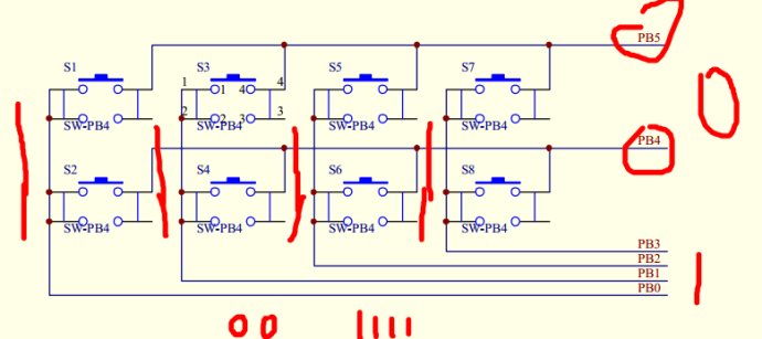

我们知道在51单片机中,通过扫描某个口的电平高低得知那个按键按下,比如,控制两行4列,假如让P1=0xCf;低位都置1 (pb0-pb3),pb4-pb5置0;然后我们就扫描P1口就行了,如果有按键被按下的,高电平会被强制拉低的。
假如按键返回的值为0xce,可知是pb0被拉低了,由此可判断是S1或者S2按下了,其他的同理。
当然只让P1=0xcf,是不能判断出具体的按键是哪个的,此时,如果我们取反既P1=0x30;
当按键返回值为0x10时,我们可得知01 0000,pb5=0,s1或者s2被按下,这个时候我们将0xce|0x10=0xde,就是唯一的值了。以此类推,得出其他的值来。
在stm32中是同样的大道理;
uint8_t KeyScan(void)
    uint8_t HangValue = 0;
    uint8_t LieValue  = 0;
    uint16_t KeyValue  = 0;
    uint8_t Tmp =0;
    static uint8_t KeyConter = 0;
    GPIO_SetBits(Colum1.port, (Colum1.pin|Colum2.pin|Colum3.pin|Colum4.pin));
    GPIO_ResetBits(Line1.port,(Line1.pin|Line2.pin));
 Tmp = GPIO_ReadInputData(Line1.port);
    if ((Tmp&0x0F) != 0x0F)
        if (KeyConter < 1)
        {//去抖
            KeyConter++;
       else
              HangValue = Tmp&0x0f;
                            GPIO_ResetBits(Colum1.port, (Colum1.pin|Colum2.pin|Colum3.pin|Colum4.pin));
            GPIO_SetBits(Line1.port,(Line1.pin|Line2.pin));
           Tmp = GPIO_ReadInputData(Colum1.port);
            LieValue = Tmp&0x30;
             KeyValue = (HangValue)|LieValue;
 if (KeyValue)// KeyValue^KeyValueBkp
                KeyValueBkp = KeyValue;
                switch (KeyValue)
          //      case KEY_10:    return KEY_NUM_0;//16;----0
                case KEY_01:    return KEY_NUM_1;//3;-----1
                case KEY_02:    return KEY_NUM_2;//4;-----2
                case KEY_03:    return KEY_NUM_3;//5;-----3
                case KEY_04:    return KEY_NUM_4;//7;-----4
                case KEY_05:    return KEY_NUM_5;//8;-----5
                case KEY_06:    return KEY_NUM_6;//9;-----6
                case KEY_07:    return KEY_NUM_7;//11----7
                case KEY_08:    return KEY_NUM_8;//------8
                default:
                    return 0;
            else
                return 0;
    else
        KeyConter = 0;  //计数清零
        KeyValueBkp = 0;
    return 0;
typedef struct
    GPIO_TypeDef        *port;
    uint16_t    pin;
}Matrix_t;
//const Matrix_t Colum1 = {GPIOD, GPIO_PIN_2};
//const Matrix_t Colum2 = {GPIOD, GPIO_PIN_3};
//const Matrix_t Colum3 = {GPIOD, GPIO_PIN_4};
const Matrix_t Colum1 = {GPIOB, GPIO_Pin_0};
const Matrix_t Colum2 = {GPIOB, GPIO_Pin_1};
const Matrix_t Colum3 = {GPIOB, GPIO_Pin_2};
const Matrix_t Colum4 = {GPIOB, GPIO_Pin_3};
const Matrix_t Line1  = {GPIOB, GPIO_Pin_4};
const Matrix_t Line2  = {GPIOB, GPIO_Pin_5};
#define KEY_01 0x1e
#define KEY_02 0x2e
#define KEY_03 0x1d
#define KEY_04 0x2d
#define KEY_05 0x1b
#define KEY_06 0x2b
#define KEY_07 0x17
#define KEY_08 0x27
