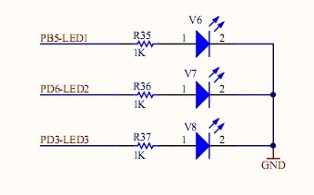

 原理图:

* 名    称:void LED_Config(void)
* 功    能:LED 控制初始化函数
输入
void LED_Config(void){
  RCC_APB2PeriphClockCmd(RCC_APB2Periph_GPIOB | RCC_APB2Periph_GPIOD , ENABLE);
  GPIO_InitStructure.GPIO_Pin = GPIO_Pin_5;     //LED1  V6   //将V6,V7,V8 配置为通用推挽输出
  GPIO_InitStructure.GPIO_Mode = GPIO_Mode_Out_PP;
  GPIO_InitStructure.GPIO_Speed = GPIO_Speed_50MHz; //口线翻转速度为50MHz
  GPIO_Init(GPIOB, &GPIO_InitStructure);
  GPIO_InitStructure.GPIO_Pin = GPIO_Pin_6|GPIO_Pin_3; //LED2, LED3 V7 V8
  GPIO_Init(GPIOD, &GPIO_InitStructure);
