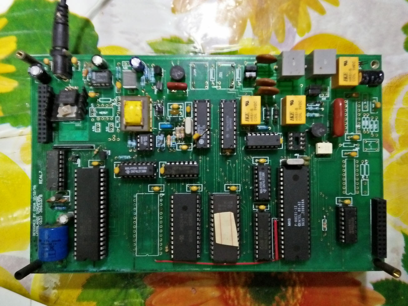

8052单片机制作台式通讯机
这是我早些年制作台时通信设备是写的代码,其中包括许多外部元件如实时时钟,IO口扩展,LCD显示的应用,程序也包括对输入字串解读并执行相应程序的方法,作为自己不时参照之用,也和大家分享。

LCALL WRITEROM
MOV 12H,#200 ;20MS IF 12MHZ
LCALL DL_200M
INC 49H
DJNZ R6,CLEANDATA2
INC 48H
DJNZ R7,CLEANDATA1
XCLEANDATA:
RET
FINDNSAVE:
;FIND EMPTY PLACE TO STORE DATA
;ERASE ALL DATA WITH SPACE
MOV 48H,#0 ;BANK 0
MOV R7,#HALFBANK ;#8
FINDNSAVE1:
MOV 49H,#1 ;SECTOR 0
MOV R6,#MAXSECTOR-1 (32*256=8K)
FINDNSAVE2:
MOV A,#1 ;ONE CHR
MOV 14H,#0 ;LEFT
LCALL READROMQUICK
MOV DPTR,#FLASH_BF
MOVX A,@DPTR
XRL A,#2AH ;"*"
JZ SAVEDATA
MOV A,#1 ;ONE CHR
MOV 14H,#128 ;RIGHT
LCALL READROMQUICK
MOV DPTR,#FLASH_BF
MOVX A,@DPTR
XRL A,#2AH ;"*"
JZ SAVEDATA
INC 49H
DJNZ R6,FINDNSAVE2
INC 48H
DJNZ R7,FINDNSAVE1
XFINDNSAVE:
LCALL LCLEAR2
MOV DPTR,#MSG80
LCALL LCDMSG
LCALL LONG_DL
RET
SAVEDATA:
LCALL READROM ;RESTORE BUFFER
MOV DPTR,#RECBF ;SOURCE
MOV 1EH,DPH
MOV 1FH,DPL
MOV DPTR,#FLASH_BF ;TARGET
MOV DPL,14H
MOV 47H,#128 ;DATA LEN
LCALL MOVEMEM
LCALL WRITEROM
LCALL LCLEAR2
MOV DPTR,#MSG81
LCALL LCDMSG
LCALL FLASHADDMSG
LCALL LONG_DL
RET
DELETEDATA: ;YOU MUST MARKSURE EVERYTHING COMEBACK
LCALL LCLEAR1
MOV DPTR,#MSG84
LCALL LCDMSG
LCALL FLASHADDMSG
MOV DPTR,#MSG85
LCALL LCDMSG
LCALL MAKESURE
JB 09H,XDELETEDATA
JB 19H,XDELETEDATA
XRL A,#89 ;"Y"
JNZ XDELETEDATA
LCALL READROM
MOV DPTR,#FLASH_BF
JNB 20H,DELETEDATA1
MOV DPL,#128
DELETEDATA1:
MOV A,#2AH
MOVX @DPTR,A
LCALL LCLEAR1
LCALL FLASHADDMSG
MOV A,#32
LCALL LCDST
MOV DPTR,#MSG84
LCALL LCDMSG
LCALL WRITEROM
LCALL LONG_DL
XDELETEDATA:
LCALL LCLEAR1
LCALL KEY_CLR
LCALL KEYPREFIX
LCALL REV_CUR
CLR 19H
RET
MAKESURE:
LCALL KRELEASE
SETB 79H ;SURE CAP
CLR 19H ;TIMEOUT
CLR 28H
MOV 31H,#MAXTIME
MAKESURE1:
LCALL GETKEY
JB 28H,MAKESURE2
JB 19H,XMAKESURE
LJMP MAKESURE1
MAKESURE2:
LCALL LCDST
XMAKESURE:
RET
SHOWNAME: ;FOR CALLER ID NAME DISPLAY
SETB 0FH ;DATABANK
SETB 39H
MOV 48H,#0 ;START FROM BANK0
MOV 49H,#1 ;START FROM SECTOR1
CLR 20H
CLR 26H ;ENABLE SEARCH
CLR 3AH ;SEARCHDN
MOV 1CH,#1 ;SEARCH FROM FIELD#2
MOV 1DH,#1 ;SEARCH FROM FIELD#2
SETB 3BH ;DON'T SHOW DATA
LCALL SEARCHALL ;DATA
CLR 3BH
JB 0AH,SHOWNAME1
SETB 25H
MOV 1CH,#0 ;SHOW FIELD#1
MOV 14H,#0
LCALL SHOW_DATA
CLR 25H
AJMP XSHOWNAME
SHOWNAME1:
CLR 20H
MOV 1CH,#2 ;SEARCH FROM FIELD#3
MOV 1DH,#2 ;SEARCH FROM FIELD#3
SETB 3BH
CLR 3BH
JB 0AH,XSHOWNAME0
SETB 25H
MOV 14H,#0
LCALL SHOW_DATA
AJMP XSHOWNAME
XSHOWNAME0:
LCALL LCLEAR2
MOV DPTR,#MSG86
LCALL LCDMSG
XSHOWNAME:
CLR 39H
CLR 0FH
RET
