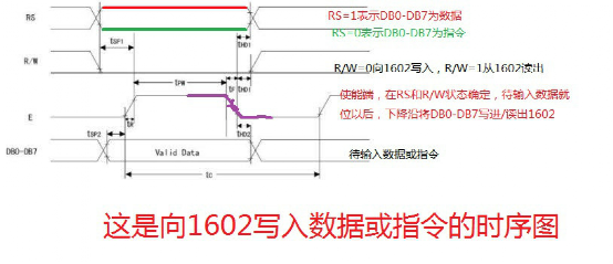

Library ieee;
Use ieee.std_logic_1164.all;
Use ieee.std_logic_unsigned.all;
Entity LCD1602 is
Port(clk,CR:in std_logic;
     RW,EN,RS:out std_logic;
       Qdata:out std_logic_vector(7 downto 0));
end;
Architecture LCD of LCD1602 is
signal Qfp:integer range 0 to 4999999;
signal cp:std_logic;
begin
  process(clk,CR)
     begin
          if CR='0' then
                Qfp<=0;
                    cp<='0';
               elsif clk'event and clk='1' then
                     Qfp<=Qfp+1;
                         if Qfp=0 then
                            cp<=not cp;
                         end if;
               end if;
     end process;
     RW<='0';
     EN<=cp;
     process(cp)
        variable cnt:integer range 0 to 37;
        begin
          if CR='0' then
             cnt:=0;
               Qdata<="00000001";
          elsif cp'event and cp='1' then
              cnt:=cnt+1;
          end if;
          case cnt is
          -------Init LCD1602-----------
          when 0 =>RS<='0';Qdata<="00111000";  --0x38,
          when 1 =>RS<='0';Qdata<="00001100";  --0x0C
          when 2 =>RS<='0';Qdata<="00000001";  --0x01
          when 3 =>RS<='0';Qdata<="00000110";  --0x60
          when 4 =>RS<='0';Qdata<="10000000";  --display,0x00+0x80,1h1w
          -------data display-------------
          when 5=>RS<='1';Qdata<="10100000";--空格
      when 6=>RS<='1';Qdata<="10100000";--空格
      when 7=>RS<='1';Qdata<="10100000";--空格
      when 8=>RS<='1';Qdata<="01011001"; --Y
      when 9=>RS<='1';Qdata<="01110101";--u
      when 10=>RS<='1';Qdata<="01101010";--j
      when 11=>RS<='1';Qdata<="01101001";--i
      when 12=>RS<='1';Qdata<="01100001";--a
      when 13=>RS<='1';Qdata<="01101110";--n
      when 14=>RS<='1';Qdata<="01110001";--q
      when 15=>RS<='1';Qdata<="01110101";--u
      when 16=>RS<='1';Qdata<="01100001";--a
      when 17=>RS<='1';Qdata<="01101110";--n
      when 18=>RS<='1';Qdata<="10100000";---空格
      when 19=>RS<='1';Qdata<="10100000";---空格
      when 20=>RS<='1';Qdata<="10100000";---空格
        when 21=>RS<='0';Qdata<="11000000";--设定显示的位置在10H+80H,
       when 22=>RS<='1';Qdata<="01000100";---D diangong xueyuan
     when 23=>RS<='1';Qdata<="01101001";---i
     when 24=>RS<='1';Qdata<="01100001";---a
     when 25=>RS<='1';Qdata<="01101110";---n
     when 26=>RS<='1';Qdata<="01100111";---g
     when 27=>RS<='1';Qdata<="01101111";---o
     when 28=>RS<='1';Qdata<="01101110";--n
     when 29=>RS<='1';Qdata<="01100111";---g
     when 30=>RS<='1';Qdata<="10100000";--- 空格
     when 31=>RS<='1';Qdata<="01011000";---X
     when 32=>RS<='1';Qdata<="01110101";---u
     when 33=>RS<='1';Qdata<="01100101";---e
     when 34=>RS<='1';Qdata<="01111001";---y
     when 35=>RS<='1';Qdata<="01110101";---u
     when 36=>RS<='1';Qdata<="01100001";---a
     when 37=>RS<='1';Qdata<="01101110";---n
     end case;
      end process;
     end;

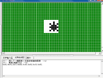

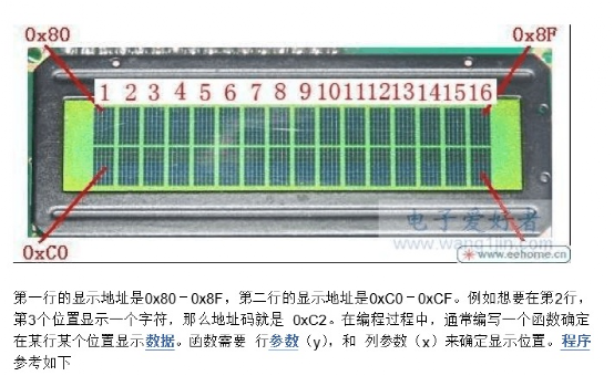

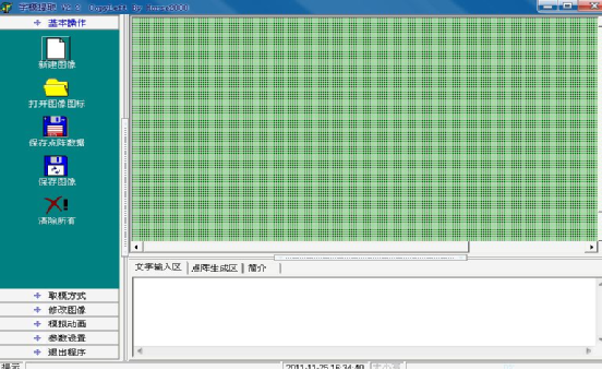

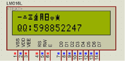

LCD1602显示自定义字符或汉字
Library ieee;
Use ieee.std_logic_arith.all;
Entity LCD1602 is
end;
signal Qfp:integer range 0 to 499999;
Type GCROM is array(0 to 63)of std_logic_vector(7 downto 0);
constant xx:GCROM:=(
X"00",X"00",X"00",X"1F",X"00",X"00",X"00",X"00",--一
X"00",X"00",X"0E",X"00",X"1F",X"00",X"00",X"00",--二
X"00",X"1F",X"00",X"0E",X"00",X"1F",X"00",X"00",--//三
X"02",X"04",X"0F",X"12",X"0F",X"0A",X"1F",X"02",--//年
X"0F",X"09",X"0F",X"09",X"0F",X"09",X"09",X"11",--//月
X"1F",X"11",X"11",X"1F",X"11",X"11",X"1F",X"00",--//日
X"00",X"00",X"00",X"0A",X"15",X"0A",X"04",X"00",--//心型
X"00",X"04",X"15",X"0E",X"1F",X"0E",X"11",X"00"
  when 128 =>RS<='0';Qdata<="00111000";  --0x38,
  when 129 =>RS<='0';Qdata<="00001100";  --0x0C
  when 130=>RS<='0';Qdata<="00000001";  --0x01
  when 131 =>RS<='0';Qdata<="00000110";  --0x60
  when 132 =>RS<='0';Qdata<="10000000";  --display,0x00+0x80,1h1w
  when 133=>RS<='1';Qdata<="00000000";--空格
      when 134=>RS<='1';Qdata<="00000001";--空格
      when 135=>RS<='1';Qdata<="00000010";--空格
      when 136=>RS<='1';Qdata<="00000011"; --Y
      when 137=>RS<='1';Qdata<="00000100";--u
      when 138=>RS<='1';Qdata<="00000101";--j
      when 139=>RS<='1';Qdata<="00000110";--i
      when 140=>RS<='1';Qdata<="00000111";--a
      when 141=>RS<='1';Qdata<="00000000";--n
      when 142=>RS<='1';Qdata<="00000001";--q
      when 143=>RS<='1';Qdata<="00000010";--u
      when 144=>RS<='1';Qdata<="00000100";--a
      when 145=>RS<='1';Qdata<="00000110";--n
      when 146=>RS<='1';Qdata<="00000111";---空格
      when 147=>RS<='1';Qdata<="10100100";---空格
      when 148=>RS<='1';Qdata<="10100110";---空格
    when 149=>RS<='0';Qdata<="11000000";--设定显示的位置在10H+80H,
   when 150=>RS<='1';Qdata<="00000111";---D diangong xueyuan

LCD1602相比大家都比较了解,但是我们一般只用来显示字符,数字。
最近在网上看许多人用LCD1602来显示汉字,觉得有趣
于是拜读了一些资料,教程,但感觉大部分相当晦涩难懂,本人认为既然是教程,就不必要相当的复杂,毕竟人家看完许久后还是不能得出实验结果~!!
接下我谈谈我得做法,保证你10分钟之内一样可以在LCD1602上显示你想显示的各种符号,汉字!!!

可能到这里,也许会有些疑问,既然自定义字符、汉字的代码需要我们自己输入,那么我该怎么编写这些代码,呵呵,不要着急,接下来就要用到下面这个取字模软件。。

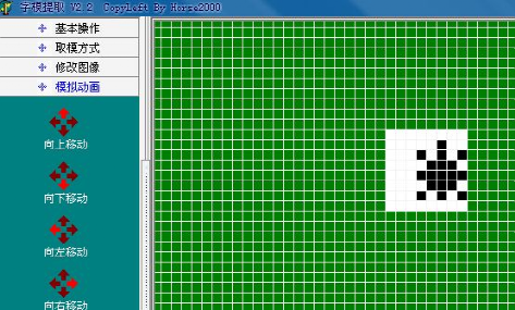

相信有的朋友应该都用过这个软件。那么我们怎么来使用这个软件来获取代码呢?大家有没有注意到,我们的LCD1602是5*8点阵(可以数一数)。但是5*8不能提取代码,最少只能8*8,所以我们这里只用后前5列,前3列不用。。
新建图像 8*8.然后再图像里面点你要显示的字符,汉字,注意是在后5列中点,黑点表示显示,白点不显示,用鼠标左键可以切换,下面是我点得一个坦克~~
点好后,就可以产生代码了,这软件里面可以选择C51或汇编,这里选择C51。
下面的8个代码就是要产生这个字符的数据。。也就是要输入到自定义字符CGRAM里面的

这里用 Proteus 仿真软件演示
附程序
