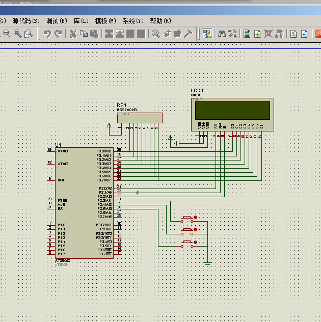

单片机万年历仿真及源程序和protel画的原理图

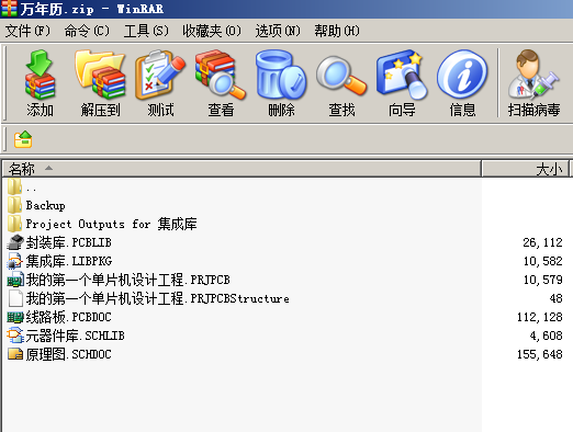

万年历的所有资料下载:
万年历.zip (118.48 KB, 下载次数: 48)
源程序:

  2. #define uint unsigned int
  4. uchar code table[]={"0000-00-00"};
  5. uchar code table1[]={"00:00:00"};
  6. uchar code table2[]={"MONTUSWEDTHUFRISATSUN"};
  7. sbit rs=P2^0;
  8. sbit rw=P2^1;
  9. sbit e=P2^2;
  10. sbit key1=P2^3;
  11. sbit key2=P2^4;
  12. sbit key3=P2^5;
