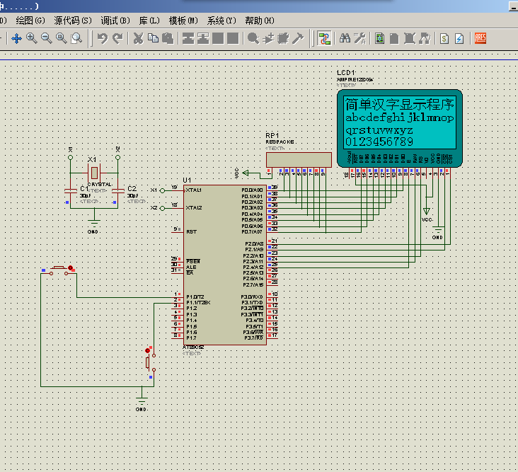

简单的LCD汉字显示程序 按键按下显示字符(不带只读 有仿真)
简单的LCD汉字显示程序附带仿真程序和C文件,按下按钮就可以显示下面的字符.下面是原理图:
仿真工程文件下载:
汉字显示程序.rar (35.84 KB, 下载次数: 27)
源程序:

  71. 0x00,0x00,0x00,0x00,0x00,0x00,0x00,0x00,0x00,0x00,0x00,0x00,0x00,0x00,0x00,0x00,
  72. 0x00,0x00,0x00,0x00,0x00,0x00,0x00,0x00,0x00,0x00,0x00,0x00,0x00,0x00,0x00,0x00,
  73. 0x00,0x00,0x00,0x00,0x00,0x00,0x00,0x00,0x00,0x00,0x00,0x00,0x00,0x00,0x00,0x00,
  74. 0x00,0x00,0x00,0x00,0x00,0x00,0x00,0x00,0x00,0x00,0x00,0x00,0x00,0x00,0x00,0x00,
  75. };
  76. sbit  RST=P2^5;
  77. sbit  E=P2^4;
  78. sbit  RW=P2^3;
  79. sbit  RS=P2^2;
  80. sbit  CS2=P2^1;
  81. sbit  CS1=P2^0;
  82. sbit  K0=P1^0;
  83. sbit  K1=P1^1;
  84. sbit  K2=P1^2;
  85. uchar b,n,m;

  237.         Write_inst (0xc0);
  238.         Delay(10);
  239.         Write_inst (0xb8);
  240.         Delay(10);
  241.         Write_inst (0x40);
  242.         Delay(10);
  243. }
  244. void main(){
  245.                 while(1)  {
  246. if(K0==0){Init_lcd();
  247. clear_screen();}
  248. if(K1==0){        Init_lcd();
  249.         clear_screen();
  250.
  251.
  252. for(n=0;n<4;n++){ display2(1,0,n,0,n);
  253.         display2(2,0,n,0,4+n);         }
  254. for(n=0;n<8;n++){ display1(1,2,n,0,n);
  255.         display1(2,2,n,0,8+n);         }
  256. for(n=0;n<8;n++){ display1(1,4,n,1,n);
  257.         display1(2,4,n,1,8+n);         }
  258. for(n=0;n<8;n++){ display1(1,6,n,2,n);
  259.         display1(2,6,n,2,8+n);         }
  260.         Init_lcd();
  261. /*        display2(1,1,0,0,0);
  262.         display2(1,1,1,0,1);
  263.         display2(1,2,2,0,2);
  264.         display2(1,2,3,0,3);
  265.         display2(1,2,4,0,4);
  266.         display2(1,2,5,0,5);
  267.         display2(1,2,6,0,6);
  268.         display2(1,2,7,0,7);        */
  269.         }
  270.          }          }
