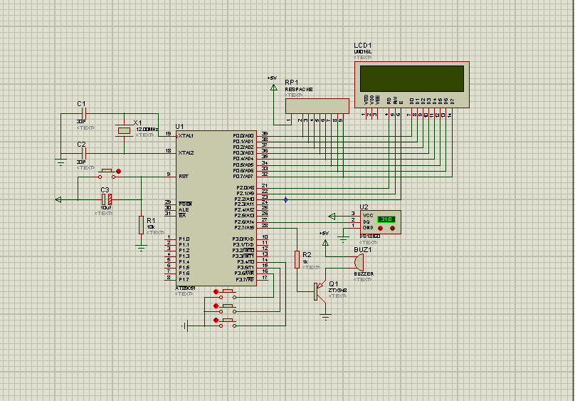

温度检测报警程序(可调上下限)
#include <reg52.h>
#include <intrins.h>
#define uint unsigned int
#define uchar unsigned char
sbit DQ=P2^2;//ds18b20与单片机连接口
sbit RS=P1^0;
sbit RW=P1^1;
sbit EN=P2^5;
sbit en573=P2^6;
sbit en1573=P2^7;
uchar data disdata[5];
uint tvalue,CurrentT=0;//温度值
uchar tflag;//温度正负标志
#define LCD_BUS P0
sbit SetKey= P3^4;
sbit UpKey= P3^5;
sbit DnKey= P3^6;
sbit BEEP= P2^3;
unsigned char AlarmTempLow=10,AlarmTempTop=40,Set=0,NG=0;

void main(void)
        unsigned char i=0; //P3=0xef;
        P2=0xef;BEEP=1;
        LCD_Initial();         //LCD 初始化
        P0=0x00;
        en573=1;
        en573=0;
        P0=0x00;
        en1573=1;
        en1573=0;
        Read_Temperature(); //读取温度值
        writestring(1,0,"DS18B20 Alarmer");          //显示“DS18B20 Alarmer”
        delayms(1000);                //延时1S
        writestring(0,0,"Current T=      ");          //显示“Current T= ”
        writestring(0,1," Low=10  Top=40 ");          //显示“ Low=10  Top=40 ”
        NG=0;
                 Read_Temperature();        //        //读取温度值
                Display_Temperature();                //显示温度值
                SetFun();
                if((CurrentT<(AlarmTempTop*10))&&(CurrentT>(AlarmTempLow*10)))
                        BEEP=1;
                else if((CurrentT>(AlarmTempTop*10)))
                                BEEP=0;
                                delayms(200);
                                BEEP=1;
                                delayms(200);
                else if((CurrentT<(AlarmTempLow*10))||(tflag==1))
                                BEEP=0;
                                delayms(1000);
                                BEEP=1;
                                delayms(1000);

你仿真成功了吗?
