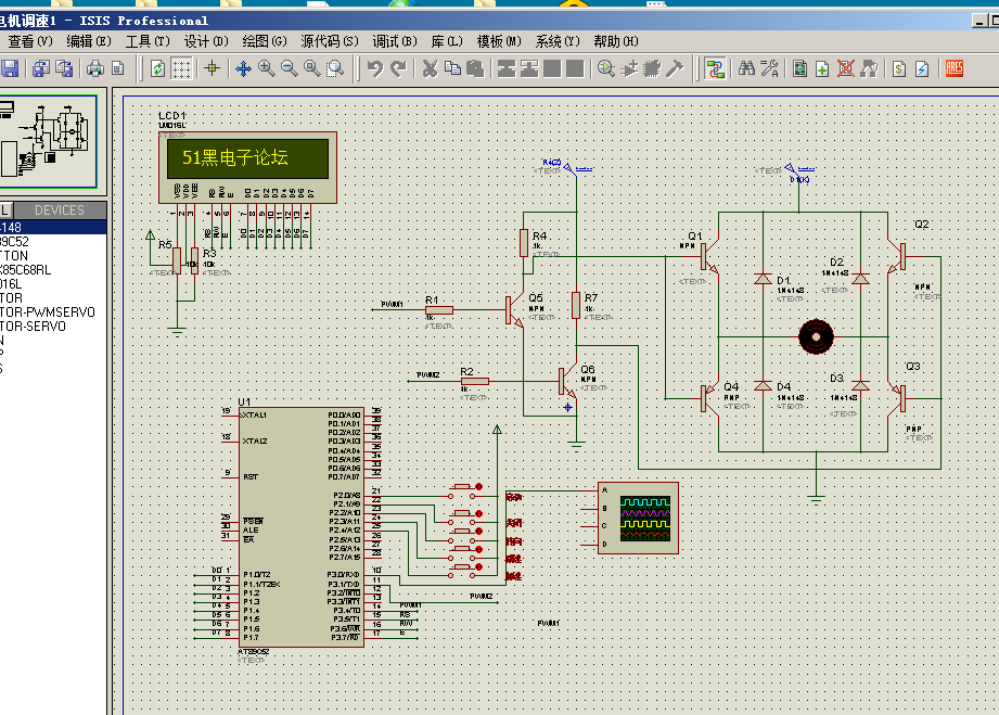

基于proteus的直流电机仿真
单片机源代码:

- /***********T0中断服务程序************PWM波的生成**********/
- void time0_int(void) interrupt 1
- time++;
- TH0 = 0xec;
- TL0 = 0x78; //60536
- if(change == 0) //正转
- PWM2 = 1;
- if(time == high) //high初始值20
- PWM1=0;
- else if(time == period) // period初始值30
- PWM1 = 1;
- time = 0;
- else //反转
- { PWM1 = 1;
- if(time == high)
- PWM2=0;
- PWM2 = 1;
- time = 0;

- /**********通过按键实现对电机开关、调速、转向的控制***************/
- void motor_control()
- if(open == 1)
- EA = 1;
- if(close == 1)
- EA = 0;
- if(swap == 1)
- change = ~change;
- while(swap != 0)
- if(sub_speed == 1)
- high++;
- if(high == 30)
- EA=0;
- while(sub_speed != 0)
- if(add_speed == 1)
- high--;
- if(high == 5)
- high = 5;
- while(add_speed != 0)
- /***************************主函数*********************************/
- void main()
- P2 = 0x00;
- ET0 = 1;
- ET1 = 1;
- TMOD = 0x11;
- TH0 = 0xec;
- TL0 = 0x78;
- TH1 = 0x3c;
- TL1 = 0xb0; //15536
- TR0 = 1;
- TR1 = 1;
- init(); //液晶显示初始化程序
- while(1)
- wc51r(0x84);
- wc51ddr('H');
- wc51ddr('e');
- wc51ddr('l');
- wc51ddr('l');
- wc51ddr('o');
- if(test == 0)
- num_medium++;
- datamade();
- motor_control();
