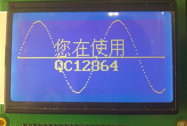

(QC)12864液晶屏串行时序驱动程序解
作者:佚名   来源:本站原创   点击数:…  更新时间:2011年09月22日   【字体:大 中 小】
串行时序不能读操作的情况下可绘制任意函数曲线
//程序格式粗糙,无暇整理,若参考有疑问请留言
完整的源代码下载:http://www.51hei.com/f/12864c5.rar

//画正弦波的波形
void print_sinx(void)
 uchar i;
 uchar xdata y_sin[128];   //定义屏幕上要打的正弦波的纵坐标
    uchar code v[128]={32,32,32,32,32,32,32,32,32,32,32,32,32,32,32,32,32,32,32,32,32,32,32,32,32,32,32,32,32,32,32,32,
32,32,32,32,32,32,32,32,32,32,32,32,32,32,32,32,32,32,32,32,32,32,32,32,32,32,32,32,32,32,32,32,32,32,32,32,32,32,32,32,
32,32,32,32,32,32,32,32,32,32,32,32,32,32,32,32,};
 float y;
 for(i=0;i<128;i++)
  y=31*sin(0.09*i)+0.5;   //此处系数为31比较好
   y_sin[i]=32-y;
  for(i=0;i<64;i++)
 LCD_draw_word(y_sin, i);   //绘图  一行一行绘
  LCD_draw_word(v, 32);
//主函数
//用于观看显示效果
void main(void)
 LCD_init();
 LCD_Setaddress(2,3);
 print("您在使用");
 LCD_Putstring(3,3,a);
// LCD_write_dat(0x35);
 LCD_draw_clr();
 print_sinx();
    while(1);
