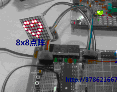

单片机开发板是自己做的,电路很简单8*8点阵的行和列分别接在单片机的p0口和p1口,p0口记得要上拉电阻哦,我测试成功见图片,
#include <reg52.H>
unsigned char code tab[]={0xfe,0xfd,0xfb,0xf7,0xef,0xdf,0xbf,0x7f};
unsigned char code graph[]={0x30,0x48,0x44,0x22,0x44,0x48,0x30,0x00};
unsigned char cnta;
void main(void)
unsigned int i,j;
 TMOD=0x01;
 TH0=(65536-2000)/256;
 TL0=(65536-2000)%256;
 TR0=1;
 ET0=1;
 EA=1;
void t0(void) interrupt 1 using 0
P1=tab[cnta];
P0=graph[cnta];
cnta++;
if(cnta==8)
   cnta=0;
