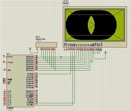

240_128_lcd 51单片机总线驱动-速度到达最大
作者:佚名   来源:本站原创   点击数:…  更新时间:2012年02月08日   【字体:大 中 小】
全部源代码下载:http://www.51hei.com/f/128yhj.rar

     y0--;
     if(sub>0)              //判断下下个点的位置
       x0++;
       sub+=2*dx-2*dy;
     else
       sub+=2*dx;
    sel_point(x0,y0);
             画圆 圆点(x,y) 半径 r
 void draw_circle(int x, int y, int r)
    int a, b, num;
    a = 0;
    b = r;
    while(2 * b * b >= r * r)          // 1/8圆即可
        sel_point(x + a, y - b); // 0~1
        sel_point(x - a, y - b); // 0~7
        sel_point(x - a, y + b); // 4~5
        sel_point(x + a, y + b); // 4~3
        sel_point(x + b, y + a); // 2~3
        sel_point(x + b, y - a); // 2~1
        sel_point(x - b, y - a); // 6~7
        sel_point(x - b, y + a); // 6~5
        a++;
        num = (a * a + b * b) - r*r;
        if(num > 0)
            b--;
            a--;
void lcd_init()
     lcd_writecom_two(0x00,0x00,0x24);
        lcd_writecom_two(0x00,0x00,0x21);
        lcd_writecom_two(0x00,0x00,0x42);
        lcd_writecom_two(0x28,0x00,0x43);//28
        lcd_writecom_two(0x00,0x00,0x40);
        lcd_writecom_two(0x01e,0x00,0x41);//1e
        lcd_writecom(0xa0);
        lcd_writecom(0x98);
        lcd_writecom(0x80);
main()
unsigned char i;
  lcd_init();
 Draw_line(0,0,239,127);
 Draw_line(0,127,239,0);
  Draw_line(0,0,239,0);
  Draw_line(0,127,239,127);
  Draw_line(0,0,0,127);
  Draw_line(239,0,239,127);
 for(i=60;i<150;i++)
 draw_circle(i,64, 60);
