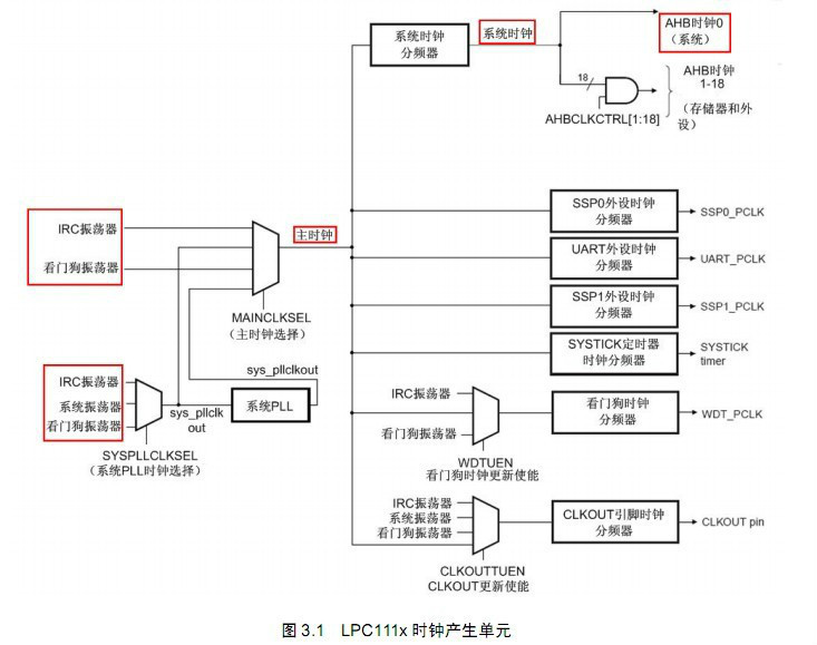

  一般我们在main()的开始部分都需要进行时钟的初始化,根据需要可以选择时钟源、是否开启PLL倍频、以及PLL配置达到所需要的输出时钟,然后再选择倍频后的时钟作为主时钟源。
如下图:需要注意几个时钟的概念,

void Main_PLL_Setup ( void )
  uint32_t regVal;
  ClockSource = OSC_CLK;
  LPC_SYSCON->SYSPLLCLKSEL = MAIN_CLKSRCSEL_Val;   /* Select system OSC--系统振荡器 */
  LPC_SYSCON->SYSPLLCLKUEN = 0x01;                 /* Update clock source */
  LPC_SYSCON->SYSPLLCLKUEN = 0x00;                 /* toggle Update register once */
  while ( !(LPC_SYSCON->SYSPLLCLKUEN & 0x01) );    /* Wait until updated */
  regVal = LPC_SYSCON->SYSPLLCTRL;
  regVal &= ~0x1FF;
  LPC_SYSCON->SYSPLLCTRL = (regVal | (MAIN_PLL_P_Val<<5) | MAIN_PLL_M_Val);/* P=1, M=4 FCLKOUT=12*4=48Mhz */
  /* Enable main system PLL, main system PLL bit 7 in PDRUNCFG. */
  LPC_SYSCON->PDRUNCFG &= ~(0x1<<7);              /* PDRUNCFG第七位写0,即系统PLL上电 */
  while ( !(LPC_SYSCON->SYSPLLSTAT & 0x01) );     /* Wait until it's locked 确定PLL锁定以后向下执行 */
  LPC_SYSCON->MAINCLKSEL = 0x03;                /* Select PLL clock output--选择PLL输出作为主时钟 */
  LPC_SYSCON->MAINCLKUEN = 0x01;                /* Update MCLK clock source --允许更新主时钟*/
  LPC_SYSCON->MAINCLKUEN = 0x00;                /* Toggle update register once */
  while ( !(LPC_SYSCON->MAINCLKUEN & 0x01) );     /* Wait until updated 确定主时钟锁定以后向下执行 */
  LPC_SYSCON->SYSAHBCLKDIV = SYS_AHB_DIV_Val;     /* SYS AHB clock, typical is 1 or 2 or 4 --SYSAHBCLKDIV的值为1,即不分频 使AHB时钟设置为48Mhz */
#if MAIN_PLL_SETUP
  SystemFrequency = ClockSource * (MAIN_PLL_M_Val+1);
#else
  SystemFrequency = ClockSource;
#endif
  SystemAHBFrequency = (uint32_t)(SystemFrequency/SYS_AHB_DIV_Val);
  return;
