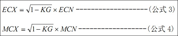

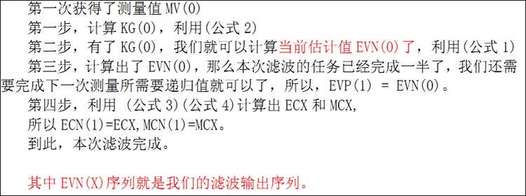

//计算卡尔曼增益
KalmanGain=EstimateCovariance*sqrt(1/(EstimateCovariance*EstimateCovariance+MeasureCovariance*MeasureCovariance));
//计算本次滤波估计值
EstimateValue=EstimateValue+KalmanGain*(Measure-EstimateValue);
//更新估计协方差
EstimateCovariance=sqrt(1-KalmanGain)*EstimateCovariance;
//更新测量方差
MeasureCovariance=sqrt(1-KalmanGain)*MeasureCovariance;
//返回估计值
return EstimateValue;
