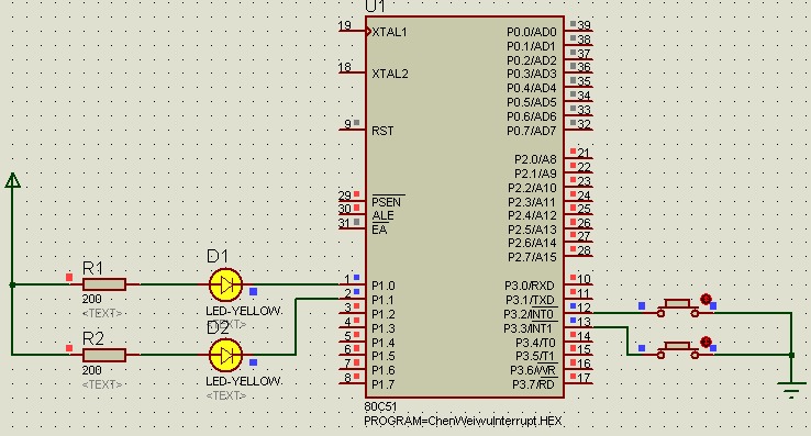

; This program is edit by Chen Weiwu
;           Date  2012/11/08  10:42:36
Led0    Bit      P1.0
Led1    Bit    P1.1
            org    000H
      ajmp   main
      ORG    003H
      AJMP   INTERRUPT0
      ORG    013H
      AJMP   INTERRUPT1
;-----Initiation-----
InterType:  SETB   EA
      Setb   IT0
      Setb   EX0
      CLR    PX0
      Setb   IT1
      Setb   EX1
      Setb   PX1
      ret
INTERRUPT0:
      clr    led0
      jnb    int0,$
      RETI
INTERRUPT1:
      clr    led1
      jnb    int1,$
      setb      led1
      RETI
main:
      acall   InterType
Mainloop:   setb   led0
      setb   led1
            Ajmp      Mainloop
      end
