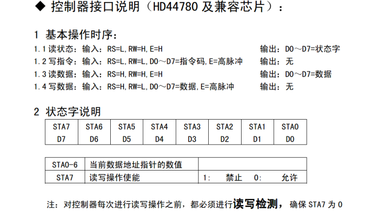

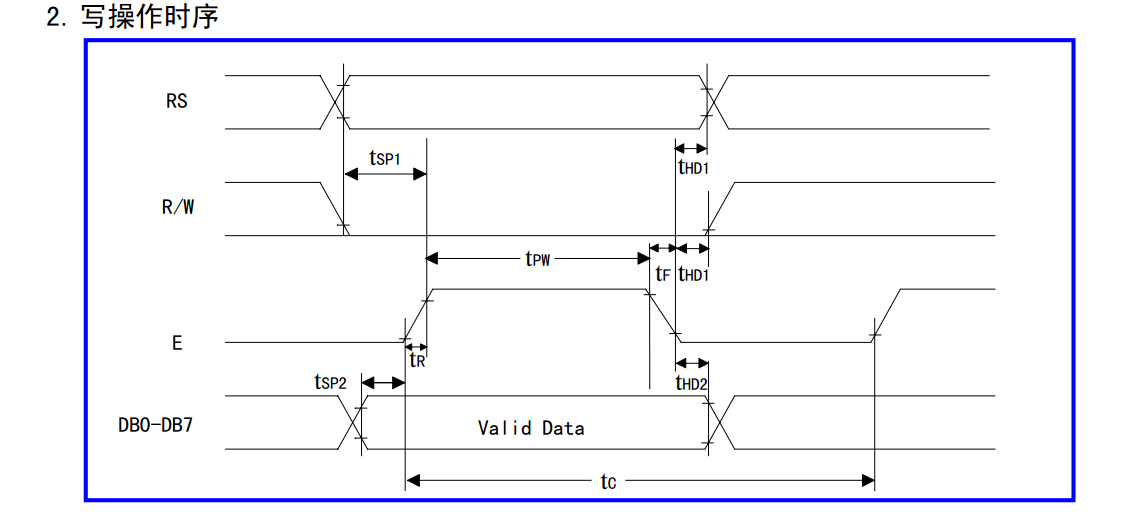

void write_command(uchar command)//写指令
lcddatecommand=0;
lcdwrite=0;
P0=command;
delay(1);
lcde=1;
delay(1);
lcde=0;
void write_date(uchar date)//写数据
lcddatecommand=1;
lcdwrite=0;
P0=date;
delay(5);
lcde=1;
delay(5);
lcde=0;

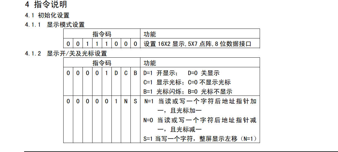

write_command(0x38);//设置16*2显示,5*7点阵,8位数据接口
write_command(0x0c);//设置开显示,不显示光标
write_command(0x06);// 写一个字符后地址指针加1
write_command(0x01);//显示清0,数据指针清0

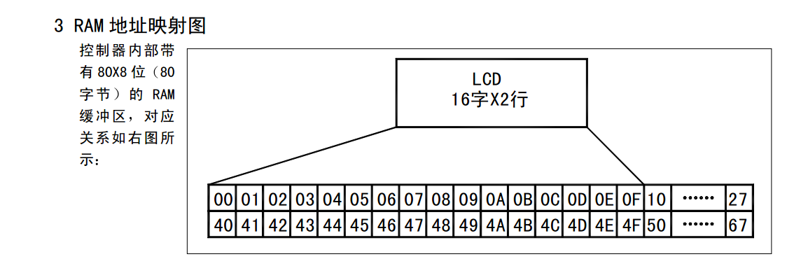

write_command(0x80+0x10);
for(i=0;i<7;i++)
write_date(LA_Mask[i]);
delay(1);
write_command(0x80+0x50);
for(i=0;i<8;i++)
write_date(AT_Eagle[i]);
delay(1);
