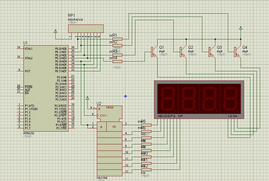

      在单片机系统中,如果并行口的IO资源不够,那么我们可以使用74LS164来扩展并行IO口,节约单片机IO资源。74LS164是一个串行输入并行输出的移位寄存器,并带有清除端。
      74LS164的引脚可以查看数据手册。
proteus仿真图和代码附上。
#include<reg51.h>
#define HIGH                1
#define LOW                    0
#define SEG_PORT            P0
sbit DATA = P0^4;
sbit CLK = P0^5;
unsigned char Timer0IRQEvent = 0;
unsigned char Time1SecEvent = 0;
unsigned int TimeCount = 0;
unsigned char SegCurPosition = 0;
code unsigned char SegCode[10] = {~0x3F,~0x06,~0x5B,~0x4F,~0x66,~0x6D,~0x7D,~0x07,~0x7F,~0x6F};
code unsigned char SegPosition[4] = {0xFE,0xFD,0xFB,0xF7};
unsigned char SegBuf[4] = {0};
void LS164_DATA(unsigned char x)
    if(x)
        DATA = 1;
    else
        DATA = 0;
void LS164_CLK(unsigned char x)
    if(x)
        CLK = 1;
    else
        CLK = 0;
*函数名称:LS164Send
*输    入:byte单个字节
*输    出:无
*功    能:74LS164发送单个字节
void LS164Send(unsigned char byte)
    unsigned char j;
    for(j=0;j<=7;j++)
        if(byte&(1<<(7-j)))
            LS164_DATA(HIGH);
        else
            LS164_DATA(LOW);
        LS164_CLK(LOW);
        LS164_CLK(HIGH);
*函数名称:SegRefreshDisplayBuf
*输    入:无
*输    出:无
*功    能:数码管刷新显示缓存
void  SegRefreshDisplayBuf(void)
     SegBuf[0] = TimeCount%10;
     SegBuf[1] = TimeCount/10%10;
     SegBuf[2] = TimeCount/100%10;
     SegBuf[3] = TimeCount/1000%10;
*函数名称:SegDisplay
*输    入:无
*输    出:无
*功    能:数码管显示数据
void SegDisplay(void)
    unsigned char t;
    SEG_PORT = 0x0F;
    t = SegCode[SegBuf[SegCurPosition]];
    LS164Send(t);
    SEG_PORT = SegPosition[SegCurPosition];
    if(++SegCurPosition >= 4)
        SegCurPosition = 0;
*函数名称:TimerInit
*输    入:无
*输    出:无
*功    能:定时器初始化
void TimerInit(void)
    TH0 = (65536 - 5000)/256;
    TL0 = (65536 - 5000)%256;
    TMOD = 0x01;
*函数名称:Timer0Start
*输    入:无
*输    出:无
*功    能:定时器启动
void Timer0Start(void)
    TR0 = 1;
    ET0 = 1;
*函数名称:PortInit
*输    入:无
*输    出:无
*功    能:I/O初始化
void PortInit(void)
    P0 = P1 = P2 = P3 = 0xFF;
*函数名称:main
*输    入:无
*输    出:无
*功    能:函数主题
void main(void)
    PortInit();
    TimerInit();
    Timer0Start();
    SegRefreshDisplayBuf();
    EA = 1;
        if(Timer0IRQEvent)
            Timer0IRQEvent = 0;
            if(Time1SecEvent)
                Time1SecEvent = 0;
                if(++TimeCount >= 9999)
                     TimeCount = 0;
            SegDisplay();
