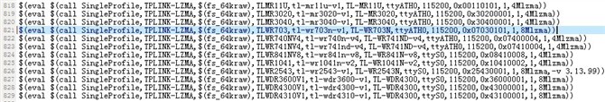

三、8M固件支持(新版本需要修改两个文件)
  703n 最新SVN trunk版本更新很大, 原来修改8m flash的结构体消失了
(1)/tools/firmware-utils/src/mktplinkfw.c 中代码:
static struct flash_layout layouts[] = {
                .id                = "4M",
                .fw_max_len        = 0x3c0000,
                .kernel_la        = 0x80060000,
                .kernel_ep        = 0x80060000,
                .rootfs_ofs        = 0x140000,
                .id                = "4Mlzma",
                .rootfs_ofs        = 0x100000,
                .id                = "8M",
                .fw_max_len        = 0x7c0000,
                .id                = "8Mlzma",
                /* terminating entry */
static struct board_info boards[] = {
                .id                = "TL-WR703Nv1",
                .hw_id                = HWID_TL_WR703N_V1,
                .hw_rev                = 1,
                .layout_id        = "4Mlzma",     //
只需将此处修改为8Mlzma
(2)在imagebuilder下面修改(如果用imagebuilder 来编译固件,需修改此处!)
/target/linux/ar71xx/image/Makefile
把703n最后的4Mlzma改成8Mlzma!
所有设置完成后用make defconfig检查,确保得到类似以下结果:
