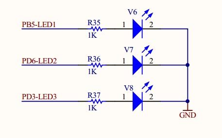

原理图:
调PB5的亮度

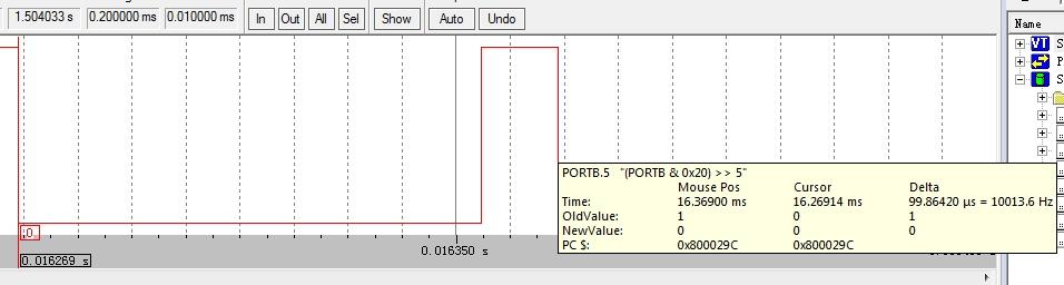

配置初始化,初始化PB5为复用输出,TIM3部分映射到PB5,设置PWM的时钟为72M/(3*2400)=10K,初始化TIM3时钟,
占空比为
CCR2_Val /(TIM_Period  +1)

  GPIO_InitStructure.GPIO_Pin = GPIO_Pin_5; //PB5复用为TIM3的通道2
  GPIO_InitStructure.GPIO_Mode = GPIO_Mode_AF_PP;
  GPIO_InitStructure.GPIO_Speed = GPIO_Speed_50MHz;
  GPIO_Init(GPIOB, &GPIO_InitStructure);

  TIM3CLK=72MHz  预分频系数Prescaler=2 经过分频 定时器时钟为24MHz
  根据公式 通道输出占空比=TIM3_CCR2/(TIM_Period+1),可以得到TIM_Pulse的计数值
  捕获/比较寄存器2 TIM3_CCR2= CCR2_Val
  TIM3_TimeBaseStructure.TIM_Prescaler = 2;    //预分频器TIM3_PSC=3 24M
  TIM3_TimeBaseStructure.TIM_CounterMode = TIM_CounterMode_Up; //计数器向上计数模式 TIM3_CR1[4]=0
  TIM3_TimeBaseStructure.TIM_Period =2399;            //自动重装载寄存器TIM3_APR  确定频率为10KHz
