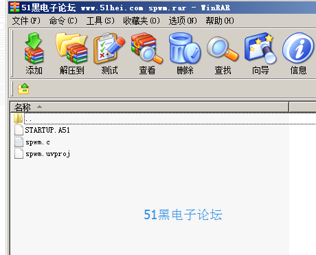

51单片机spwm程序
产生spwm的简单程序
  1. #include<reg52.h>
  2. unsigned char code x[]={66,38,78,26,89,15,97,7,
  3. 102,2,103,1,103,1,102,2, 97,7,89,15,78,26,66,38, 38,66,26,78,15,89,7,97, 2,102,1,103,1,103,2,102, 7,97,15,89,26,78,38,66};
  4.         unsigned int i,j,m,k;
  5. sbit L1=P2^0;
  6. void init()
  7. {
  8. TMOD=0X02;
  9. TH0=(255-x[i]);
  10. TL0=(255-x[i]);
  11. EA=1;
  12. ET0=1;
  13. TR0=1;
  14. L1=1;
  15. }
  16. void main()
  17. {
  18.    init(); //???P2.0??SPWM?
  19.          while(1);}
  20. void timer0() interrupt 1
  21.         {
  22.      TH0=(255-x[i]); TL0=(255-x[i]);
  23.             j++; if(j==8) { } j=0; L1=~L1; i++;
  24.            if(i>=48) i=0;}
spwm.rar
