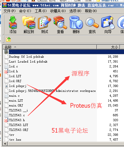

仿真和完整源码下载地址:http://www.51hei.com/bbs/dpj-91718-1.html
