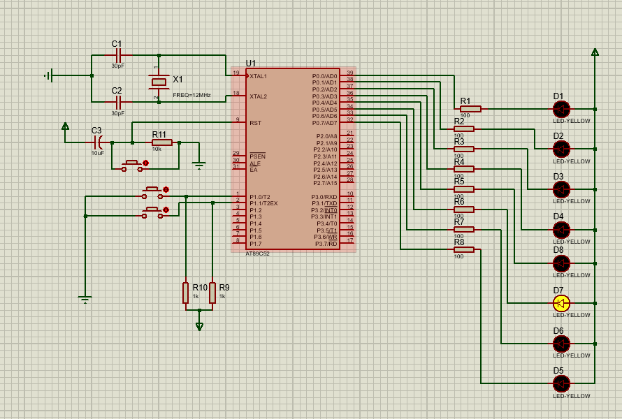

#include <REGX51.H>#include <intrins.h>
#define uint unsigned int
sbit K1=P1^0;
sbit K2=P1^1;
void delayms(uint xms)
uint i,j;
for(i=xms;i>0;i--)
for(j=110;j>0;j--);
void main()
uint num=4,a=0XFE;
if(K1==0)
num=0;
if(K2==0)
num=1;
switch(num)
case 0:P0=a;delayms(500);a=_crol_(a,1);break;
case 1:P0=a;delayms(500);a=_cror_(a,1);break;
按键控制流水灯.rar
(66.92 KB, 下载次数: 90)
