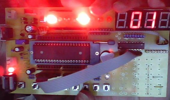

  此程序是在黄莺老师的源程序上加以修改,在单片机板子上运行成功,这里是板子的硬件资料http://www.51hei.com/mcu/1019.html,数码管是四位共阳管子,程序没有进行仿真测试
 #include <reg51.h>
 #define uint unsigned int
 #define uchar unsigned char
 uint temp,temp1,temp2,num,shi,ge,i,j;
 uchar code table[]=
{0xc0,0xf9,0xa4,0xb0,0x99,0x92,0x82,0xf8,0x80,0x90};
 sbit WX1=P0^0;
 sbit WX2=P0^1;
 sbit WX3=P0^2;
 sbit WX4=P0^3;
 sbit NBL=P2^2;
 sbit NBY=P2^1;
 sbit NBR=P2^0;
 sbit DXL=P2^5;
 sbit DXY=P2^4;
 sbit DXR=P2^3;
 void init()
  P0=0xff;
  P2=0xff;
  temp=0;
  temp1=0;
  temp2=0;
  shi=0;
  ge=0;
  TMOD=0x21;
  TH0=0x3c; //50ms
  TL0=0xb0;
  EA=1;
  ET0=1;
  TF0=0;
  TR0=1;
 void delay(uchar z)
  uchar x,y;
  for(x=110;x>0;x--)
   for(y=z;y>0;y--);
 void display()
  shi=num/10;
  ge=num%10;
  P1=table[ge];
  WX3=1;
  WX2=0;WX1=0;WX4=0;
  delay(10);
  WX2=1;
  P1=table[shi];
  WX2=1;
  WX3=0;WX1=0;WX4=0;
  delay(10);
  WX3=1;
  void time0() interrupt 1 using 1
  temp++;
  temp1++;
  TH0=0x3c;
  TL0=0xb0;
  TR0=1;
 void main()
  init();
if(temp==0)
DXR=1;
NBY=1;
DXL=0;
NBR=0;
num=21;
temp1=0;
for(i=20;i>0;i--)
num--;
while(temp1!=20)
display();
temp1=0;
if(temp==400)
DXY=1;
NBR=0;
DXL=0;
num=3;
j=0;
for(i=7;i>0;i--)
j++;
if(j%2==0)
num--;
temp2=temp;
DXL=!DXL;  //灯闪烁
while(temp-temp2!=10)
display();
if(temp==470)
    DXL=1;
 DXY=0;
 NBR=0;
 num=3;
 temp1=0;
 for(i=3;i>0;i--)
 num--;
 while(temp1!=20)
 display();
 temp1=0;
if(temp==530)
 DXY=1;
 DXR=0;
 NBR=1;
 NBL=0;
 num=26;
 temp1=0;
 for(i=25;i>0;i--)
 num--;
 while(temp1!=20)
 display();
 temp1=0;
if(temp==1030)
DXY=1;
DXR=0;
NBL=0;
num=3;
j=0;
for(i=7;i>0;i--)
j++;
if(j%2==0)
num--;
temp2=temp;
NBL=!NBL;  //灯闪烁
display();
if(temp==1100)
    DXL=1;
 DXR=0;
 NBY=0;
 num=3;
 temp1=0;
 for(i=3;i>0;i--)
 num--;
 while(temp1!=20)
 display();
 temp1=0;
temp=0;
