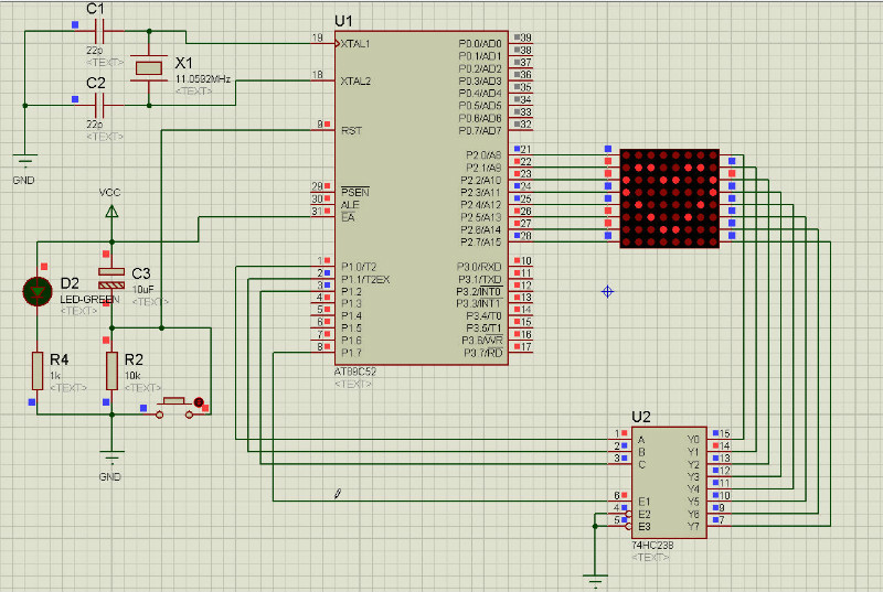

写不下去了  直接上代码
#include <reg52.h>
typedef unsigned char uint8;
typedef unsigned int uint16;
sbit acon=P1^0;      //38译码器
sbit bcon=P1^1;
sbit ccon=P1^2;
sbit en=P1^7;         //译码器使能
uint8 j=0,k=0;
uint16 i=0;
code uint8 ledcode[]={ 0xFF,0xFF,0xFF,0xFF,0xFF,0xFF,0xFF,0xFF,  //
  0xFF,0xC3,0xE7,0xE7,0xE7,0xE7,0xC3,0xFF,  //    I
  0xFF,0x99,0x66,0x7E,0xBD,0xDB,0xE7,0xFF,  //   心
  0xFF,0x99,0x99,0x99,0x99,0x99,0xC3,0xFF,  //   U
  0xFF,0xFF,0xFF,0xFF,0xFF,0xFF,0xFF,0xFF };  //     哄老婆用

仿真图:
