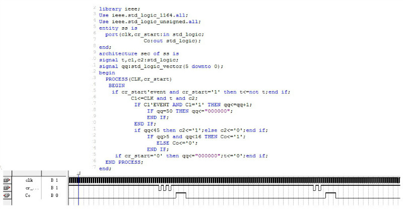

  锁定一段时间的及时程序:
      library ieee;
Use ieee.std_logic_1164.all;
Use ieee.std_logic_unsigned.all;
entity ss is
  port(clk,cr_start:in std_logic;
              Co:out std_logic);
end;
architecture sec of ss is
signal t,c1,c2:std_logic;
signal qq:std_logic_vector(5 downto 0);
begin
  PROCESS(CLK,cr_start)
   BEGIN
    if cr_start'event and cr_start='1' then t<=not t;end if;
          C1<=CLK and t and c2;
           IF C1'EVENT AND C1='1' THEN qq<=qq+1;
               IF qq=50 THEN qq<="000000";
               END IF;
           END IF;
           if qq<45 then c2<='1';else c2<='0';end if;
               IF qq>5 and qq<16 THEN Co<='1';
                  ELSE Co<='0';
               END IF;
     if cr_start='0' then qq<="000000";t<='0';end if;
  END PROCESS;
end;

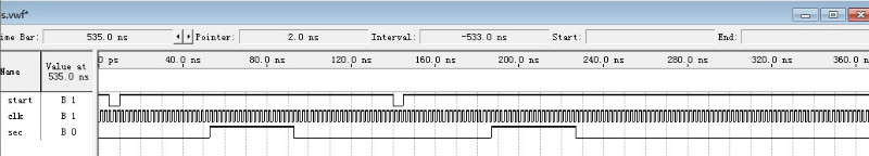

下面是波形仿真:按一下开始键可以从新开始这段计时。

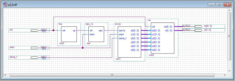

---------------------------原理图完成频率计整体测试-----------------------------
