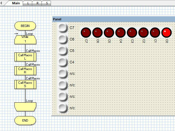

程序介绍:灯为左右移动加闪烁,程序中采用了调用子程序功能

void FCM_L();
void FCM_R();
void FCM_S();
//Variable declarations
char FCV_AR;
char FCV_AS;
char FCV_AL;
char FCV_COUNT;
//Macro implementations
void FCM_L()
 FCV_COUNT = 0;
 while (FCV_COUNT<2)
  FCV_AL = 0x01;
  while (FCV_AL>0)
   trisc = 0x00;
   portc = FCV_AL;
   delay_ms(100);
   FCV_AL = FCV_AL<<1;
  FCV_COUNT = FCV_COUNT+1;
void FCM_R()
 FCV_COUNT = 0;
 while (FCV_COUNT<2)
  FCV_AR = 0x80;
  while (FCV_AR>0)
   trisc = 0x00;
   portc = FCV_AR;
   delay_ms(100);
   FCV_AR = FCV_AR>>1;
void FCM_S()
 FCV_COUNT = 0;
 while (FCV_COUNT<2)
  FCV_AS = 0xFF;
  trisc = 0x00;
  portc = FCV_AS;
  delay_ms(100);
  FCV_AS = 0x00;
  trisc = 0x00;
  portc = FCV_AS;
  delay_ms(100);
void main()
 //Initialisation
 ansel = 0;
anselh = 0;
 //Interrupt initialisation code
 option_reg = 0xC0;
 //Loop
 //Loop: While 1
 while (1)
  FCM_L();
  FCM_R();
  FCM_S();
 mainendloop: goto mainendloop;
