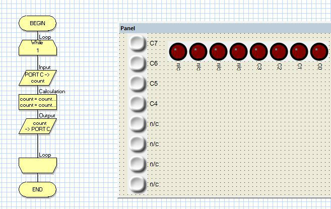

程序介绍:使用同一个IO口进行设置,高字节为按键,低字节为灯,流程中嵌入关系式变化:
 FCV_COUNT = FCV_COUNT>>4;
FCV_COUNT = FCV_COUNT & 0x0f;

 //Loop: While 1
 while (1)
  //Input
  //Input: PORT C -> count
  trisc = trisc | 0xff;
  FCV_COUNT = portc;
  //Calculation
  //Calculation:
  //  count = count>>4
  //  count = count AND 0x0f
  //Output
  //Output: count -> PORT C
  trisc = 0x00;
  portc = FCV_COUNT;
 mainendloop: goto mainendloop;
