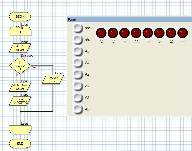

程序介绍:简单的按键按下,相应的灯亮,按键弹起,灯灭。只有一个按键哦,相应的也只是一个灯亮。

//Loop: While 1
while (1)
//Input
//Input: A0 -> count
trisa = trisa | 0x01;
FCV_COUNT = ((porta & 0x01) == 0x01);
//Decision
//Decision: count=1?
if (FCV_COUNT==1)
//Output
//Output: count -> C0
trisc = trisc & 0xfe;
if (FCV_COUNT)
portc = (portc & 0xfe) | 0x01;
else
portc = portc & 0xfe;
} else {
//Input
//Input: PORT A -> count
trisa = trisa | 0xff;
FCV_COUNT = porta;
//Output
//Output: count -> PORT C
trisc = 0x00;
portc = FCV_COUNT;
