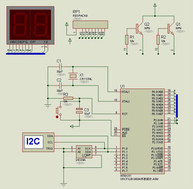

程序功能:统计单片机的开机次数。
#include<reg52.h>
#include<intrins.h>
#define uint unsigned int
#define uchar unsigned char
sbit sda=P1^1;
sbit scl=P1^0;
uchar temp=0;
uchar data_h,data_l;
uchar state;
const uchar tab[]={0xc0,0xf9,0xa4,0xb0,0x99,0x92,0x82,0xf8,0x80,0x90};

汇编程序:
;24c02的开机计数器,系统复位一次数码管加1
SDA24 EQU P1.1
SCLK24 EQU P1.0
SCLK24 EQU P1.0
ORG 0000H
AJMP MAIN
ORG 0030H
MAIN:
CLR P3.7 ;打开写保护
MOV DPTR,#TAB
MOV A,#00H ;读地址
LCALL RD24
CJNE A,#10,TT
TT: JNC TT1
AJMP TT2
TT1: MOV A,#00
TT2: MOV 30H,A
MOVC A,@A+DPTR
SETB P2.0 ;开数码管
MOV P0,A ;送显示
AJMP MAIN
