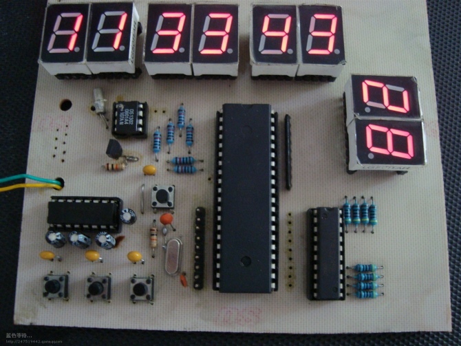

基于89S51的实时数字温度计(DS1302 18B20)

sbit DS_RST  = P1^2;    //DS复位端
sbit DS_CLK  = P1^0;    //SCLK端
sbit DS_IO   = P1^1;    //IO端
sbit DS18B20 = P1^3; //温度传感器接口
bit keyboard,flash,STA=1;
uchar choose,a;
uchar collect_time[3]={0x45,0x23,0x11};//定义变量秒分时
uchar collect_temperature[2] = {0};
uchar num[10] = {0x7e,0x48,0x3d,0x6d,0x4b,0x67,0x77,0x4c,0x7f,0x6f};
   //七段数码管显示的段码
uchar display[8] = {0x01,0x02,0x03,0x04,0x05,0x06,0x07,0x08};
