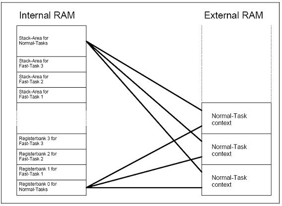

RTX-51 recognizes two classes of tasks:
1.       Fast tasks
n       Contain especially short responses and interrupt disable times.
n       Contain a separate register bank and a separate stack area (register banks 1, 2 and 3).(Figure 1)
n       Contain the highest task priority (priority 3) and can therefore interrupt standard tasks.
n       All contain the same priority and can therefore not be mutually interrupted.
n       Can be interrupted by c51 interrupt functions.
n       A maximum of three fast tasks can be active in the system.
2.       Standard tasks
n       Require somewhat more time for the task switching compared to fast tasks.
n       Share a common register bank and a common stack area (register bank 0).
n       The current contents of registers and stack are stored in the external (XDATA) memory during a task change.
n       Can be interrupted by fast tasks.
n       Can interrupt themselves mutually.
n       Can be interrupt by c51 interrupt functions.
n       A maximum 16 standard tasks can be active in the system.
