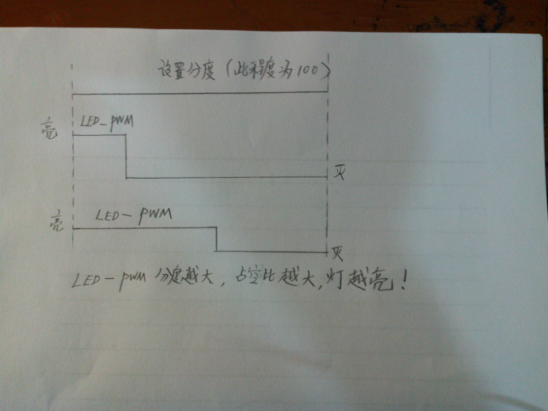

stc12单片机LED_PWM调光

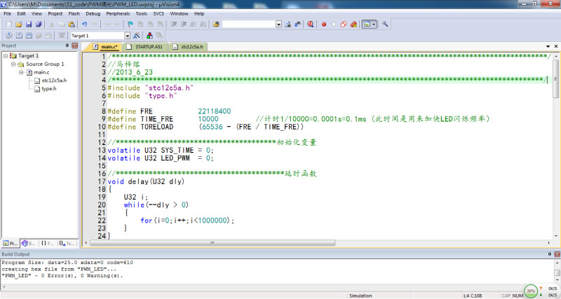

本程序一共有3个文件下面分别列出:
stc12c5a.h 头文件下载:http://www.51hei.com/mcu/3282.html
main.c
 #include "stc12c5a.h"
#include "type.h"
#define FRE         22118400
#define TIME_FRE   10000         //计时1/10000=0.0001s=0.1ms (此时间是用来加快LED闪烁频率)
#define T0RELOAD   (65536 - (FRE / TIME_FRE))
//***************************************初始化变量
volatile U32 SYS_TIME = 0;
volatile U32 LED_PWM  = 0;

//*****************************************定时器0中断
void Timer0_Routine() interrupt 1
 TH0 = T0RELOAD / 256;
 TL0 = T0RELOAD % 256;
 //以下根据实际情况修改程序
 SYS_TIME ++;
 if(SYS_TIME < LED_PWM)
  P0 = 0;    //点亮LED
 else
  P0 = 0XFF;  //关闭LED
 if(SYS_TIME > 100)
 {SYS_TIME = 0;}
