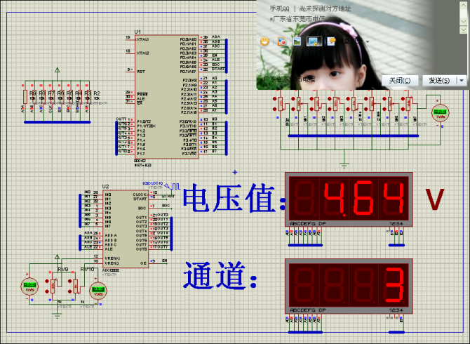

八通道adc0808数据采集
作者:佚名   来源:互联网   点击数:…  更新时间:2014年09月17日   【字体:大 中 小】
#include<reg52.h>
#define uint unsigned int
#define uchar unsigned char
sbit EN=P0^4;
sbit EOC=P0^6;
sbit STA=P0^7;
sbit ADA=P0^0;
sbit ADB=P0^1;
sbit ADC=P0^2;
sbit ALE=P0^5;
uchar code tab[11]={0xC0,0xF9,0xA4,0xB0,0x99,0x92,0x82,0xD8,0x80,0x90,0xff};
uchar code wela[]={0x01,0x02,0x04,0x08,0x10,0x20,0x40,0x80};
uchar data shu[8]={0,0,0,0,0,0,0,0};
uint ada=1222,adb=0;
uchar alley=0;
void delay(uint z)
uint x,y;
for(x=z;x>0;x--)
for(y=4;y>0;y--);
void display()
uchar i,hp;
for(i=0;i<8;i++)
if(i==1)hp=0x80;else hp=0;
P3=wela[i];
P2=tab[shu[i]]+hp;
delay(10);
P3=0X00;
void disan()
ada=ada*100/51;
shu[4]=alley/1000;
shu[5]=alley%1000/100;
shu[6]=alley%100/10;
shu[7]=alley%10;
shu[0]=ada/1000;
shu[1]=ada%1000/100;
shu[2]=ada%100/10;
shu[3]=ada%10;
void adc()
ADA=alley&0x01;
ADB=alley&0x02;
ADC=alley&0x04;
STA=0;
delay(30);
STA=1;
delay(30);
STA=0;
while(!EOC)delay(1);
EN=1;
delay(2);
ada=P1;
EN=0;
void main()
uchar a=100;
a=1000;
alley++;
if(alley>7)alley=0;
adc();
disan();
while(a--)
display();
