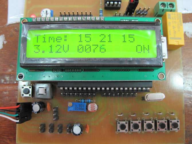

/*课程设计终于弄完了,总想共享一下源代码,*/
/*遂在51hei上贴出来,大家看有什么问题吧~如果哪里写得不好还请众亲们指出哦~*/
/*---附:实物图--*/
/*===Chip:STC12C5A32S2======================*/
/*===Software:Keil 4 C51========================*/
/*===Author:梁鹏===================================*/
/*===Organization:广西民族大学07自动化===========*/
/*===Date:2010年05月26日======================*/
/*===Version:1.0===============================*/
/*===声明:本程序属原创作品,仅供学习交流,不得用于
商业用途,如需转载,请注明出处,谢谢合作!======*/

 Locate(1,1);
 if((mode_flags==1)&&flash_flags) LCD_str_("      ");
 else LCD_str_("Time: ");    //调整模式下,“Time:”闪烁
 LCD_2char(hour);   //显示时
 if(flash_flags&&(!pause_flags)) LCD_char(' ');
 else LCD_char(':');        //非暂停模式下,“:”闪烁
 LCD_2char(min);    //显示分
 else LCD_char(':');
 LCD_2char(sec);    //显示秒
 LCD_str_("   ");
 if(mode_flags>0){display_clk();}   //暂停时,显示闹钟
 else{
  Locate(2,1);
  LCD_float_(vol_data,2);
  LCD_str_("V ");
  LCD_4char(ad_data_channal7);
  LCD_str_("   ");
  Locate(2,13);
  if(!clk_on_or_off)LCD_str_("  ON"); //全局显示闹钟的ON/OFF
  else     LCD_str_(" OFF");

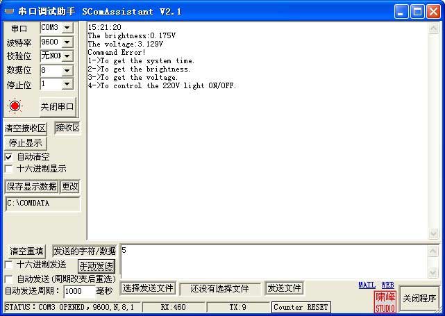

void serial_judge()
 switch(com_get){
  case 0x31:
   Uart_send_int(hour,2);
   Uart_send_(':');
   Uart_send_int(min,2);
   Uart_send_(':');
   Uart_send_int(sec,2);
   Uart_send("  \n");
   break;
  case 0x32:
   Uart_send("The brightness:");
   Uart_send_flt(vol_data1,3);
   Uart_send("V  \n");
   break;
  case 0x33:
   Uart_send("The voltage:");
   Uart_send_flt(vol_data,3);
   Uart_send("V  \n");
   break;
  case 0x34:LAMP_PORT=!LAMP_PORT;break;
  default  :
   Uart_send("Command Error! \n");
   Uart_send("1->To get the system time. \n");
   Uart_send("2->To get the brightness. \n");
   Uart_send("3->To get the voltage. \n");
   Uart_send("4->To control the 220V light ON/OFF. \n\n");
 com_get=0;
