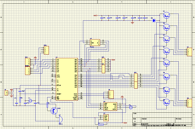

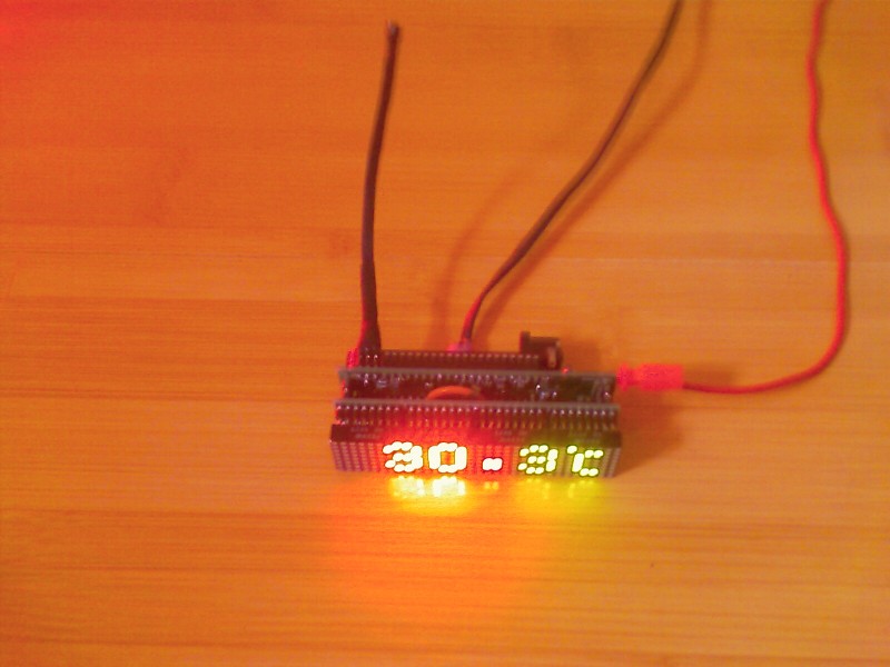

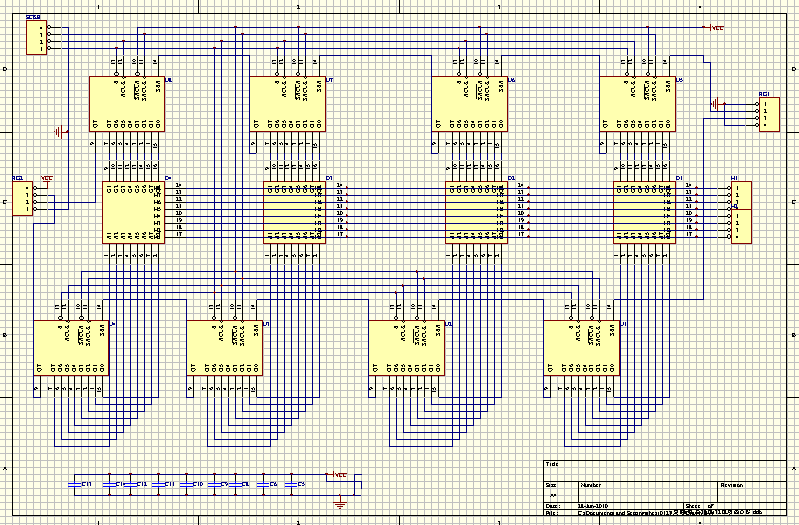

昨天晚上刚弄完工的,相机不在,用手机拍的,不清晰。日历,星期,温度,农历滚动显示:高手看了别笑话。
  1. ;***************引脚定义,根据使用不同的管脚而改动*************
  2. ;农历,星期,1302程序由网上下载
  3. ABCD    EQU    P2      ;行扫描0-7
  4. SEG     EQU    P1.1    ; 红
  5. SER     EQU    P1.0    ;内容发送绿
  6. SRCLK   EQU    P1.2    ;串行CP端
  7. RCLK    EQU    P1.3    ;输出CP端
  8. EN      EQU    P1.4    ;EN为138使能端.高电平关闭显示;低电平显示
  9. DQ      EQU    P3.6    ;温度18b20
  10. BEEP    EQU    P3.7           ;蜂鸣器
  11. AN      EQU    P0.1           ;中间按键
  12. ANS     EQU    P0.0           ;上按键
  13. ANX     EQU    P0.4           ;下按键
  14. ANZ     EQU    P0.2           ;左按键
  15. ANY     EQU    P0.3           ;右按键
  16. T_CLK   EQU    P0.7    ;实时时钟时钟线引脚
  17. T_IO    EQU    P0.6    ;实时时钟数据线引脚
  18. T_RST   EQU    P0.5    ;实时时钟复位线引脚
  19. ;温度存放地址
  20. A_BIT   EQU  22H     ;存放个位数变量
  21. B_BIT   EQU  21H     ;存放十位数变量
  22. C_BIT   EQU  24H     ;存放 小数变量
  23. D_BIT   EQU  20H     ;存放 百 位数变量
  24. FLAG    EQU  26H     ;DS18B20是否存在标志
  25. XSD     EQU  23H     ;点
  26. WDFH    EQU  25H     ;℃
  27. WDGW    EQU  27H        ;温度高位值
  28. WDDW    EQU  28H        ;温度低位值
  29. QUSHU   EQU  28H

  2640. DB 006h,0AAh,04Ch,00Ah,0d5h,041h,024h,0dAh,0B6h,004h,0B6h,04Ah,069h,057h,03dh; 2025
  2641. DB 00Ah,04eh,051h,00dh,026h,046h,05eh,093h,03Ah,00dh,053h,04dh,005h,0AAh,043h; 2030
  2642. DB 036h,0B5h,037h,009h,06dh,04Bh,0B4h,0Aeh,0Bfh,004h,0Adh,053h,00Ah,04dh,048h; 2035
  2643. DB 06dh,025h,0BCh,00dh,025h,04fh,00dh,052h,044h,05dh,0AAh,038h,00Bh,05Ah,04Ch; 2040
  2644. DB 005h,06dh,041h,024h,0Adh,0B6h,004h,09Bh,04Ah,07Ah,04Bh,0Beh,00Ah,04Bh,051h; 2045
  2645. DB 00Ah,0A5h,046h,05Bh,052h,0BAh,006h,0d2h,04eh,00Ah,0dAh,042h,035h,05Bh,037h; 2050
  2646. DB 009h,037h,04Bh,084h,097h,0C1h,004h,097h,053h,006h,04Bh,048h,066h,0A5h,03Ch; 2055
  2647. DB 00eh,0A5h,04fh,006h,0B2h,044h,04Ah,0B6h,038h,00Ah,0Aeh,04Ch,009h,02eh,042h; 2060
  2648. DB 03Ch,097h,035h,00Ch,096h,049h,07dh,04Ah,0Bdh,00dh,04Ah,051h,00dh,0A5h,045h; 2065
  2649. DB 055h,0AAh,0BAh,005h,06Ah,04eh,00Ah,06dh,043h,045h,02eh,0B7h,005h,02dh,04Bh; 2070
  2650. DB 08Ah,095h,0Bfh,00Ah,095h,053h,00Bh,04Ah,047h,06Bh,055h,03Bh,00Ah,0d5h,04fh; 2075
  2651. DB 005h,05Ah,045h,04Ah,05dh,038h,00Ah,05Bh,04Ch,005h,02Bh,042h,03Ah,093h,0B6h; 2080
  2652. DB 006h,093h,049h,077h,029h,0Bdh,006h,0AAh,051h,00Ah,0d5h,046h,054h,0dAh,0BAh; 2085
  2653. DB 004h,0B6h,04eh,00Ah,057h,043h,045h,027h,038h,00dh,026h,04Ah,08eh,093h,03eh;   2090
  2654. DB 00dh,052h,052h,00dh,0AAh,047h,066h,0B5h,03Bh,005h,06dh,04fh,004h,0Aeh,045h;   2095
  2655. DB 04Ah,04eh,0B9h,00Ah,04dh,04Ch,00dh,015h,041h,02dh,092h,0B5h,00dh,053h,049h;   2100
  2656. ;ds1302时钟上升沿输入命令或数据,下降沿输出数据.===========================================================================
