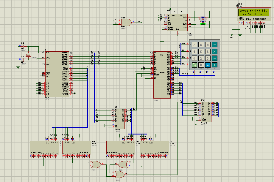

步进电机仿真实验,亲测可用
1 2控制正反转,加减控制转速。亲测可用
完整代码和仿真文件下载:http://www.51hei.com/bbs/dpj-20399-1.html

  25. main()
  26. {
  27.   void  OPJIAN();
  28.   unsigned char JIAN();
  29.   unsigned char JIANZHI();
  30.    void  speed();
  31. void  SHOW_LCD();
  32. void  show_state();
  33. void  write1();
  34. void  writ2(unsigned char i);
  35. void  delay();
  36. void time();
  37. void  busy();
  38. unsigned  char  i;
  39.   i=0x90;
  40.   PORTC0=i;
  41.   i=0x01;
  42.   TMOD=i;
  43.   t=0x10;
  44.   a=0x0f;
  45.   TH0=0x10;
  46.   TL0=0x0f;
  47.   FLG=INMA;
  48.   SHOW_LCD();
  49.   show_state();
  50.   EA=1;
  51.   ET0=1;
  52.   TR0=1;

  233. void OPJIAN() /* 键值处理程序*/
  234. {
  235.    switch(INMA)
  236. {
  237.    case 0x08:  {RUNState=Right_RUN;s=0xf7;}break;
  238.    case 0x09:  {RUNState=Left_RUN;s=0x01;}break;
  239.    case 0x0b:  {
  240.             flag=1;
  241.       t=t-2;
  242.       RunSpeed=5000000/(65536-t*256-a);
  243.       speed();}break;
  244.    case 0x0f:  {flag=1;
  245.                 t=t+2;
  246.                  RunSpeed=5000000/(65536-t*256-a);
  247.                  speed();}
  248. }
  249. }
  250. void speed()/*速度处理程序*/
  251. {
  252.   unsigned  char  i=0;
  253.   SD[0]=RunSpeed/100+48;
  254.   SD[1]=RunSpeed%100/10+48;
  255.   SD[2]=RunSpeed%10+48;
  256.   }
  257.   void time1(void) interrupt 1 using 2
  258.   {
  259.    TR0=0;
  260.    PORTC=s;
  261. if(RUNState==0)
  262. {
  263. s=(s<<1);
  264. if(s==0x10)
  265.    s=0x01;
  266. }
  267.    else
  268. {
  269.   s=s>>1;
  270. if(s==0x0f)
  271. s=0xf7;
  272.   }
  273.    TH0=t;
  274.   TL0=a;
  275.   TR0=1;
  276.   }
