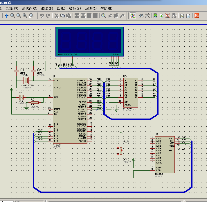

51单片机和TLC2543做的数字电压表的proteus仿真及源程序都有.
  1. #include "led.h"
  2. #include "TLC2543.h"
  3. const uchar code displayMode=0x0f;
  4. uchar displayBuff[4]={0x7e,0x7e,0x7e,0x7e};   //数码管显示缓冲区,低两位为时间,最高位为抢答号
  5. const uchar code digitalNumber[10]={0x7e,0x06,0x6d,0x79,0x33,0x5b,0x5f,0x70,0x7f,0x73};
  6. void main()
  7. {
  8.   uint voltageReadTemp;
  9.   uint voltageRead;
  10.   uchar temp;
  11.   uchar i,j;
  12.   init_led();
  13.   while(1)
  14.   {
  15.     ledSweepDisplay(displayBuff,displayMode,4);
  16.     voltageRead=read_TLC2543(0x05);
  17.         voltageRead=voltageRead*0x05;
  18.         for(i=4;i>0;i--)
  19.         {
  20.           temp=(uchar)(voltageRead/0x0fff);
  21.           if(i==4)
  22.             displayBuff[i-1]=digitalNumber[temp]|0x80;
  23.           else
  24.             displayBuff[i-1]=digitalNumber[temp];
  25.           voltageRead=voltageRead%0x0fff;
  26.           voltageReadTemp=voltageRead<<1;
  27.           voltageRead=0x0000;
  28.           for(j=0;j<5;j++)
  29.             voltageRead+=voltageReadTemp;//voltageRead=voltageRead*10
  30.
  31.         }
  32.   }
  33. }

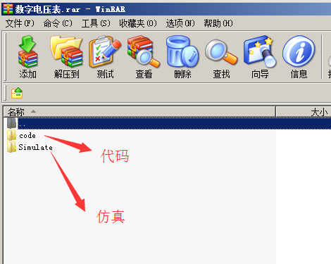

数字电压表.rar (23.19 KB, 下载次数: 104)
