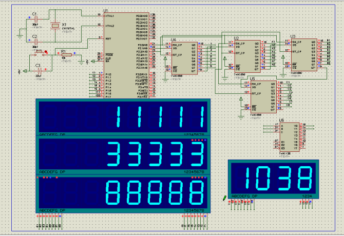

74HC595是一个8位移位寄存器的数字芯片,并具有输出锁存和三态输出。
既然可以驱动了那么多的数码管,驱动大屏点阵还是梦?绝对不是梦?

附上仿真图:
驱动程序也很简单:
#include<reg51.h>
#include<intrins.h>
#define uchar unsigned char
uchar code display[]={0xc0,0xf9,0xa4,0xb0,0x99,0x92,0x82,0xf8,0x80,0x90};
uchar buf[5];
sbit SH=P2^0;
sbit SDA=P2^1;
sbit ST=P2^2;
uchar count,sec,min;
void delay(unsigned char i)
 unsigned char j=220;
   while(i--)
   while(j--);
void write_595(uchar p)
 uchar i,temp;
 temp=p;
 for(i=0;i<8;i++)
  if(temp&0x80) SDA=1;
  else SDA=0;
  SH=0;
  _nop_();
  _nop_();
  SH=1;
  temp<<=1;
void init_T()   //中断和定时器初始化
 IE=0x82;  //打开总中断,定时器T1和T0中断
 TMOD=0x01;  //设定T1,T0位工作方式1
 TH0=0x9e;
 TL0=0x58;  //T0装初值
 TR0=1;   //开始时钟开始工作
void main()
 uchar scan,i;
 init_T();
  buf[0]=sec%10;
  buf[1]=sec/10;
//  buf[2]=;
  buf[3]=min%10;
  buf[4]=min/10;
  scan=0x01;
  for(i=0;i<5;i++)
   ST=0;
   ST=1;
   write_595(~display[buf[i]]);
   write_595(~display[sec%10]);
   write_595(~display[sec/10]);
   write_595(~display[min%10]);
   delay(1);
   P1=~scan;
   scan<<=1;
void time_T0() interrupt 1    //定时器0,工作方式1,时钟中断
 TH0=0x9e;
 TL0=0x58;       //T0装初值
 count++;
 if(count==40)
  count=0;
  sec++;
  if(sec==60)
   sec=0;
   min++;
   if(min==60)
   min=0;
