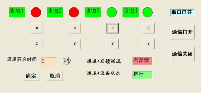

51单片机端口全部源码可以
从这里 http://www.51hei.com/f/51vbcs.rar 下载.

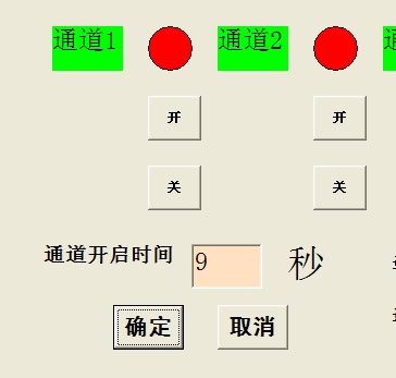

Private Sub Command11_Click()
On Error GoTo errline
If Text1.Text < 0 Then
Text1.Text = 0
End If
Timer1.Enabled = True
errline:
If Err.Number = 13 Then
MsgBox ("输入出错")
Text1.Text = 0
End If
Text1.Text = 0
End If
errline:
MsgBox ("输入出错")
Text1.Text = 0
End If
End Sub

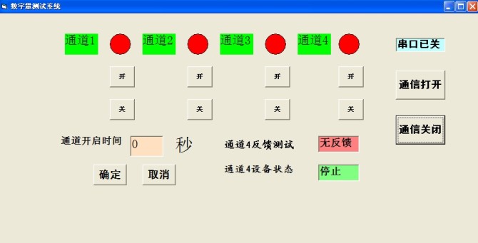

Private Sub Command9_Click()
On Error GoTo errline:
MSComm1.CommPort = 6
MSComm1.Settings = "9600,n,8,1"
MSComm1.InputMode = comInputModeText
MSComm1.InputLen = 0
MSComm1.PortOpen = True
Timer2.Enabled = True
Timer3.Enabled = True
Text3.Text = "串口已开"

Private Sub Timer1_Timer()
Text1.Text = 0
End If
Text1.Text = 0
End If
If Text1.Text = 0 Then
MSComm1.Output = "5"
MSComm1.Output = "6"
MSComm1.Output = "7"
MSComm1.Output = "8"
Shape1.FillColor = vbRed
Shape2.FillColor = vbRed
Shape3.FillColor = vbRed
Shape4.FillColor = vbRed
Timer1.Enabled = False
Exit Sub
Exit Sub
End If
Text1.Text = Text1.Text - 1
errline:
If Err.Number = 8018 Then
Text3.Text = "串口已关"
End If
Err.Clear
errline:
Text3.Text = "串口已关"
End If
Err.Clear
End Sub

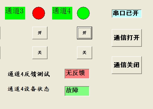

If MSComm1.Input = "9" Then
Text2.Text = "有反馈"
End If
If MSComm1.Input = "a" Then
Text2.Text = "无反馈"
End If
errline:
Text3.Text = "串口已关"
End If
Err.Clear
Text2.Text = "有反馈"
End If
Text2.Text = "无反馈"
End If
errline:
Text3.Text = "串口已关"
End If
Err.Clear
End Sub
Private Sub Timer3_Timer()
If Shape4.FillColor = vbGreen And Text2.Text = "有反馈" Then
Text4.Text = "运行"
End If
If Shape4.FillColor = vbGreen And Text2.Text = "无反馈" Then
Text4.Text = "故障"
End If
If Shape4.FillColor = vbRed And Text2.Text = "无反馈" Then
Text4.Text = "停止"
End If
Text4.Text = "运行"
End If
Text4.Text = "故障"
End If
Text4.Text = "停止"
End If
