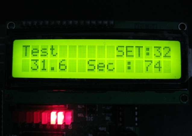

//------------------------主函数----------------------
#include <iom16.h>
#define uchar unsigned char
#define uint unsigned int
#define light PORTB_Bit7 //过温报警闪灯
uchar sec;
uchar displayflag; // 刷屏标志
uint tempset=25; //温度设定
#include"1602.h"
#include"18b20.h"
#include"serial.h"
#include "time1.h"
#include "key.h"
#include"18b20.h"
#include"serial.h"
#include "time1.h"
#include "key.h"
void port_init()
PORTA=0xff;
DDRA=0xff;
PORTB=0xff;
DDRB=0xff;
PORTC=0xff;
DDRC=0xff;
PORTD=0xff;
DDRD=0x00;
PORTA=0xff;
DDRA=0xff;
PORTB=0xff;
DDRB=0xff;
PORTC=0xff;
DDRC=0xff;
PORTD=0xff;
DDRD=0x00;
void show_temp(uint k) //显示温度值
displayonechar(1,1,(k/100)+48);
displayonechar(2,1,(k%100/10)+48);
displayonechar(3,1,'.');
displayonechar(4,1,(k%10)+48);
void show_sec(uchar k) //显示秒表
displaychar(7,1,"Sec :");
displayonechar(13,1,(k/10)+48);
displayonechar(14,1,(k%10)+48);
void show_tempset(uchar k) //显示设定值
displaychar(10,0,"SET:");
displayonechar(14,0,(k/10)+48);
displayonechar(15,0,(k%10)+48);
void main()
uint TT; //显示的温度值
uint kk;
port_init();
serial_init();
time0_init();
delay(1000);
init1602();
displaychar(0,0,"Test");
uint kk;
port_init();
serial_init();
time0_init();
delay(1000);
init1602();
TT=read_temper();
show_temp(TT);
serial_sendtemp(TT);
show_tempset(tempset);
if(displayflag==1) //秒钟变化后才刷屏
show_sec(sec);
displayflag=0;
if(TT>tempset*10) //温度大于设定值报警
kk++;
if(kk>20)
light=~light;
kk=0;
TT=read_temper();
show_temp(TT);
show_sec(sec);
displayflag=0;
kk++;
if(kk>20)
light=~light;
kk=0;
key1(); //按键设定温度值

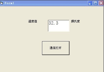

//---------------VB代码----------
Option Explicit
Private Sub Command1_Click()
MSComm1.CommPort = 6
MSComm1.PortOpen = True
MSComm1.Settings = "9600,n,8,1"
MSComm1.InputMode = comInputModeText
MSComm1.InputLen = 0
End Sub
Private Sub MSComm1_OnComm()
Text1.Text = MSComm1.Input
End Sub
