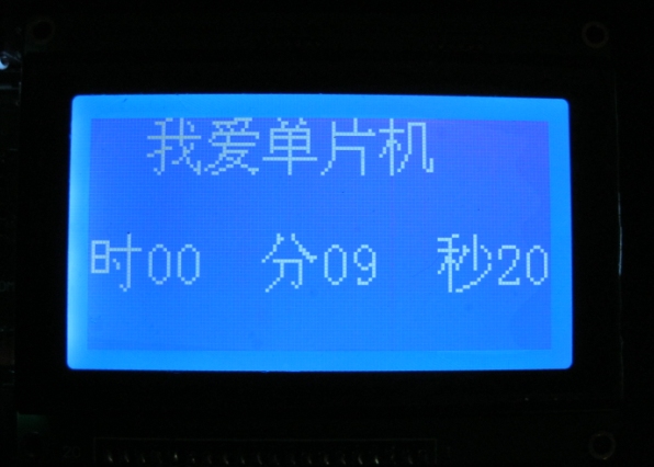

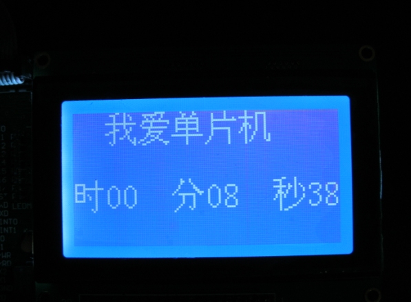

128*64代码进化版显示时,分,秒
作者:佚名   来源:本站原创   点击数:…  更新时间:2013年11月01日   【字体:大 中 小】
显示结果:
芯片晶振11.0592

void Timer0(void) //设定定时器0 50ms
    TMOD = 0x01;
    TH0 = 0x3C;
    TL0 = 0x0B0;
    EA = 1;
    ET0 = 1;
    TR0 = 1;
void time0init()interrupt 1   //定时器中断执行,时,分,秒计算
 TR0=0;
 osc++;
 if(osc==20){sec++;osc=0;}
 if(sec==60){minute++; sec=0;}
 if(minute==60){hour++;minute=0;}
 if(hour==24){hour=0;}
 hour1=hour/10;
 hour0=hour%10;
 minute1=minute/10;
 minute0=minute%10;
 sec1=sec/10;
 sec0=sec%10;
 TH0=0x3c;
 TL0=0x0B0;
 EA=1;
 ET0=1;
 TF0=0;
 TR0=1;
#include "12864hh.h"
void main(void)
 lcd_init();
 delay(1000);
 Timer0();
display_hz(2,0,0,0);
display_hz(4,0,1,0);
display_hz(6,0,2,0);
display_hz(8,0,3,0);
display_hz(10,0,4,0);
display_hz(0,4,5,0);
display_hz(6,4,6,0);
display_hz(12,4,7,0);
display_asc(2,4,hour1,0);
display_asc(3,4,hour0,0);
display_asc(8,4,minute1,0);
display_asc(9,4,minute0,0);
display_asc(14,4,sec1,0);
display_asc(15,4,sec0,0);
delay(60000);
