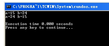

#include <string.h>
void main(void)
 int a=15,b=24;
 printf("a=%d b=%d\n",a,b);
 a=a^b;
 b=b^a;
 a=a^b;
a=15   0000 1111  ^
b=24   0001 1000
           0001 0111    =23
           0000 1111   =15
           0001 1000    =24
