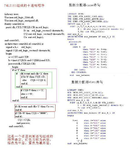

 74LS161的vhdl实现
1).Library ieee;
Use ieee.std_logic_1164.all;
Use ieee.std_logic_unsigned.all;
Entity    COurt161    IS
 port( clk,CTT,CTP,LD,CR:in std_logic;
         D: in  std_logic_vector(3 DOWNTO 0);
         CQ:out std_logic_vector(3 downto 0);
         Co: out std_logic);
end court161;
architecture     court161     of      court161    is
       signal    a,b,c:  std_logic  ;
       signal   CQI:std_logic_vector(3 downto 0);
 begin
   a<=CTT and CTP;
   b<=(not (CQI(3) and CQI(0)))and LD;
  processclk,CTP,LD,CR)                                                                begin
        if    a='1'      then
             if      clk'event and clk='1'       then
                  if   b='0'    then     CQI<=D;
                  else   CQI<=CQI+1;
                  end if;
           end if;
         if     CQI=9     then     c<='1';
          else    c<='0';
          end if;
     end if;
     if     clk'event   and   clk='1'    then    Co<=c;
     end if;
     if      CR='0'      then       CQI<="0000";
     end if;
       CQ<=CQI;
  end process;
end court161;
