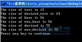

下面采用一个比较综合的例子说明一下操作系统以及各种综合的影响分析。
    #include <iostream>
    #include <string>
    #include <vector>
    class test
    public:
        test();
        virtual ~test();
        virtual void get_a_c();
    private:
        int a;
        char c;
    class derived_test:public test
    public:
        virtual ~derived_test();
    private:
        double d ;
    class base
    private:
        char a;
        static int refrence_count;
        std::string name;
        double price;
        std::vector<double> dvec;
    public:
        base();
        virtual ~base();
        static int get_count();
    int base::get_count()
        return refrence_count;
    int base::refrence_count = 0;
    class new_base
    private:
        char a;
        double price;
        std::string name;
    public:
        new_base();
        virtual ~new_base();
    int new_base::get_count()
    int new_base::refrence_count = 0;
    class derived: public base
    private:
        int min_qty;
        double discount;
        static int newp;
    public:
        derived();
        virtual ~derived(){};
    class new_derived:public new_base
    private:
        double discount;
        int min_pty;
        static int newp;
    public:
        new_derived();
        virtual ~new_derived(){}
    int main()
        std::cout << "The size of test is " << sizeof(test) << std::endl;
        std::cout << "The size of derived_test is " << sizeof(derived_test) << std::endl;
        std::cout << "The size of base is " << sizeof(base) << std::endl;
        std::cout << "The size of new_base is " << sizeof(new_base) << std::endl;
        std::cout << "The size of derived is " << sizeof(derived) << std::endl;
        std::cout << "The size of new_derived is " << sizeof(new_derived) << std::endl;
        return 0;
上面在windows和linux的结果分别如下:
windows:
Linux:
从上面的结果可以之知道在两个系统下,结果是不一样的。说明操作系统也对类的存储空间大小有较大的影响。
