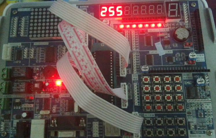

试验效果如下:
#include<reg51.h>
#define duan   P0 //段选
#define wei P2 //位选
unsigned char code wei1[8] = {
0xfe,0xfd,0xfb,0xf7,0xef,0xdf,0xbf,0x7f};//位选控制   查表的方法控制
unsigned char code duan1[17] = {
0x3f,0x06,0x5b,0x4f,0x66,0x6d,0x7d,0x07,
0x7f,0x6f,0x77,0x7c,0x39,0x5e,0x79,0x71};//0、1、2、3、4、5、6、7、8、9、A、b、C、d、E、F的显示码
unsigned char ge,shi,bai,temp;
void DigDisplay(); //动态显示函数
void init(); //初始化函数
void main(void)
 init();
  DigDisplay();
void DigDisplay()
 unsigned char i,j;
 bai=temp/100;
 shi=temp%100/10;
 ge=temp%10;
 wei = wei1[i]; //发送位选
 duan = duan1[bai];     //发送段码
 j = 10;      //扫描间隔时间设定
 while(j--);
 duan = 0x00;   //消隐
 i++;
 duan = duan1[shi];     //发送段码
 j = 10;      //扫描间隔时间设定
 while(j--);
 duan = 0x00;   //消隐
 i++;
 duan = duan1[ge];     //发送段码
 j = 10;      //扫描间隔时间设定
 while(j--);
 duan = 0x00;   //消隐
 i=0;
void init()
 TMOD=0x20;
 TH1=0xfd;
 TL1=0xfd;
 EA=1;
 TR1=1;
 SM1=1;
 REN=1;
 ES=1;
void usb() interrupt 4
 RI=0;
 temp=SBUF;
