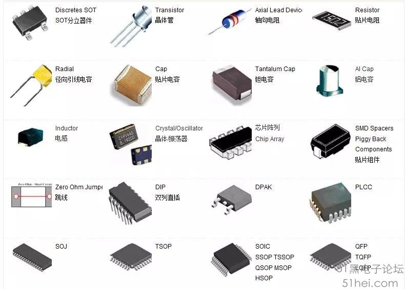

Dual In-line Package
双列直插封装
QFP
Quad Flat Package
四边引出扁平封装
PQFP
Plastic Quad Flat Package
塑料四边引出扁平封装
SQFP
Shorten Quad Flat Package
缩小型细引脚间距QFP
BGA
Ball Grid Array Package
球栅阵列封装
PGA
Pin Grid Array Package
针栅阵列封装
CPGA
Ceramic Pin Grid Array
陶瓷针栅阵列矩阵
PLCC
Plastic Leaded Chip Carrier
塑料有引线芯片载体
CLCC
Ceramic Leaded Chip Carrier
塑料无引线芯片载体
SOP
Small Outline Package
小尺寸封装
TSOP
Thin Small Outline Package
薄小外形封装
SOT
Small Outline Transistor
小外形晶体管
SOJ
Small Outline J-lead Package
J形引线小外形封装
SOIC
Small Outline Integrated Circuit Package
小外形集成电路封装
