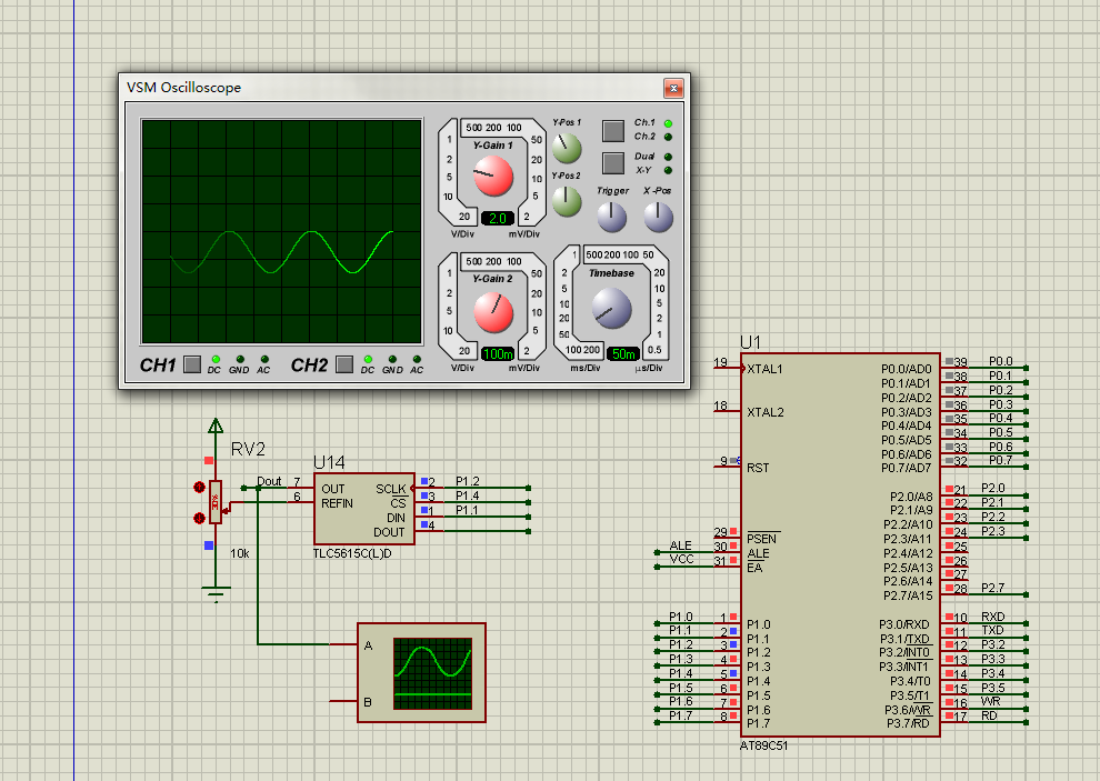

正弦信号发生器 单片机源程序与原理图
正弦信号发生器
单片机代码:
  1. #include <reg52.h>
  2. //接口定义
  3. sbit DA = P1^1;
  4. sbit CK = P1^2;

  54. 0x14c,0x14f,0x152,0x155,0x157,0x15a,0x15d,0x160,0x163,0x166,0x169,0x16c,0x16f,0x172,0x175,0x178,0x17b,0x17f,0x182,0x185,
  55. 0x188,0x18b,0x18e,0x191,0x194,0x197,0x19a,0x19d,0x1a0,0x1a3,0x1a6,0x1a9,0x1ad,0x1b0,0x1b3,0x1b6,0x1b9,0x1bc,0x1bf,0x1c2,
  56. 0x1c5,0x1c9,0x1cc,0x1cf,0x1d2,0x1d5,0x1d8,0x1db,0x1de,0x1e2,0x1e5,0x1e8,0x1eb,0x1ee,0x1f1,0x1f4,0x1f8,0x1fb
  57. };
  58. //数据写入
  59. void da5615(unsigned int da)
  60. {
  61.   unsigned char i;
  62.   da <<= 6;//10有效数据左对齐
  63.   CS = 0;
  64.   CK = 0;
  65.   for (i=0;i<12;i++)
  66.   {
  67.     DA = (bit)(da & 0x8000);
  68.     CK = 1;
  69.     da <<= 1;
  70.     CK = 0;
  71.   }
  72.   CS = 1;
  73.   CK = 0;
  74. }
  75. main()
  76. {
  77.         unsigned int j;
  78.         while(1)
  79.         {
  80.                 da5615(sine_dot[j]);
  81.                 if(++j > 1023) j=0;
  82.         }
  83. }
