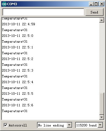

接线说明,以Arduino uno r3为例:
  SCL→A5
  SDA→A4
  VCC→5V
  GND→GND
代码部分:

 Serial.begin(115200);
void ReadDS3231()
  int second,minute,hour,date,month,year,temperature;
  second=Clock.getSecond();
  minute=Clock.getMinute();
  hour=Clock.getHour(h12, PM);
  date=Clock.getDate();
  month=Clock.getMonth(Century);
  year=Clock.getYear();
  temperature=Clock.getTemperature();
  Serial.print("20");
  Serial.print(year,DEC);
  Serial.print('-');
  Serial.print(month,DEC);
  Serial.print('-');
  Serial.print(date,DEC);
  Serial.print(' ');
  Serial.print(hour,DEC);
  Serial.print(':');
  Serial.print(minute,DEC);
  Serial.print(':');
  Serial.print(second,DEC);
  Serial.print('\n');
  Serial.print("Temperature=");  //这里是显示温度
  Serial.print(temperature);
  Serial.print('\n');
void loop()
  ReadDS3231();
  delay(1000);  //间隔1000ms(1000ms=1秒)循环一次。
