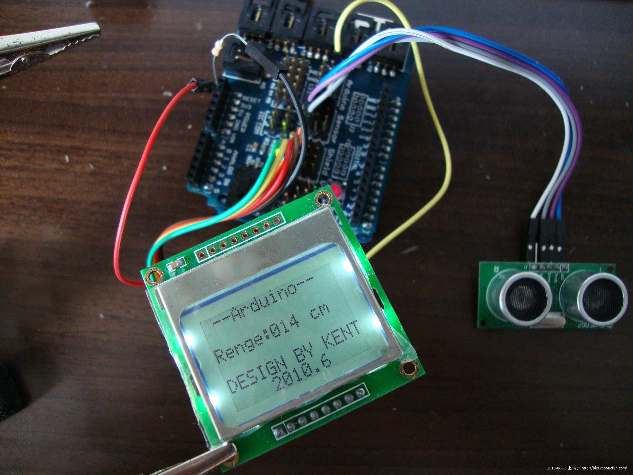

// nokia 5110 arduino驱动程序(中文,图形显示。超声波测距)
// 版本1.1
// 2010.6
//端口定义
int lcd_ce=2;
int lcd_rst=3;
int sclk=4;
int sdin=5;
int lcd_dc=6;
int inputpin=8;  // 定义超声波信号接收接口
int outputpin=9; // 定义超声波信号发出接口

void loop()
   lcd_init();//初始化液晶
   lcd_clear();//清屏
   lcd_draw_bmp_pixel(30,0,boy_bmp,24,24);        //调入上面的图像
   lcd_write_english_string(4,2,"----");          //写入ascii字符
   lcd_write_english_string(55,2,"----");
   lcd_write_chinese_string(6,3,12,6,0,0);        //写入中文字符
   lcd_write_english_string(20,5,"arduino");
   delay(5000);
   lcd_clear();                                  //清屏
   lcd_write_english_string(0,0," --arduino-- ");
   lcd_write_english_string(0,2,"renge:");
   lcd_write_english_string(0,4,"design by kent");
   lcd_write_english_string(0,5,"    2010.6    ");
  //以下进入超声波测距
      digitalwrite(outputpin, low); // 使发出发出超声波信号接口低电平2μs
      delaymicroseconds(2);
      digitalwrite(outputpin, high); // 使发出发出超声波信号接口高电平10μs,这里是至少10μs
      delaymicroseconds(10);
      digitalwrite(outputpin, low);    // 保持发出超声波信号接口低电平
      int distance = pulsein(inputpin, high);  // 读出脉冲时间
      distance= distance/58;           // 将脉冲时间转化为距离(单位:厘米)
         if(distance>120)              //如果距离大于120cm
         lcd_write_english_string(35,2,"???"); //在(35, 2)坐标上显示“???”
         else
          lcd_write_english_string(60,2,"cm");     //如果小于120cm
          lcd_set_xy(35, 2);                       //在(35, 2)坐标上显示测出数值
          lcd_write_char( 0x30+distance00/100); //显示百位数
          lcd_write_char( 0x30+distance0/10);   //显示十位数
          lcd_write_char( 0x30+distance);       //显示个位数
