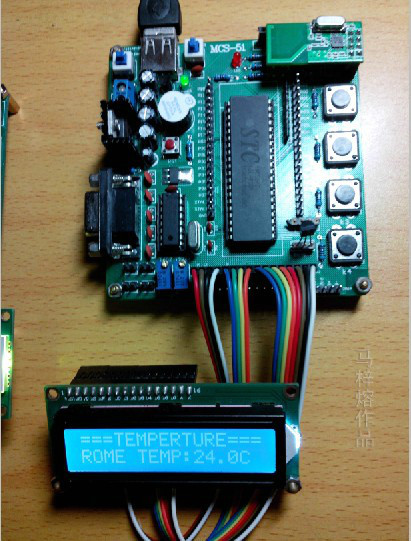

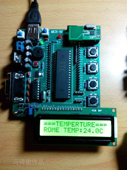

nRF24L01+无线温度(DS18B20)测控系统

nrf24l01+1.h
#define uchar unsigned char
#define uint unsigned int
sbit  MISO =P1^4;
sbit  MOSI =P1^3;
sbit SCK     =P1^2;
sbit CE     =P1^0;
sbit CSN  =P1^1;
sbit IRQ  =P1^5;
//****************************************************函数声明
void inerDelay_us(uchar n);
void init_NRF24L01(void);
uchar SPI_RW(uchar byte);
uchar SPI_Read(uchar reg);
//void SetRX_Mode(void);
uchar SPI_RW_Reg(uchar reg, uchar value);
//uchar SPI_Read_Buf(uchar reg, uchar *pBuf, uchar uchars);
uchar SPI_Write_Buf(uchar reg, uchar *pBuf, uchar uchars);
//uchar nRF24L01_RxPacket(uchar* rx_buf);
void nRF24L01_TxPacket(uchar * tx_buf);
uchar  bdata sta;   //状态标志
sbit RX_DR =sta^6;
sbit TX_DS =sta^5;

ds18b20.h
#include <reg52.h>
#include <intrins.h>
#include "LCD1602display.h"
uchar code range[]="===TEMPERTURE===";
uchar code ASCII[]="0123456789.";
uchar code table0[]="ROME TEMP:00.0C ";
uchar code table1[]="    ERRO !!!    ";
uchar temp[3]={0,0,0};
sbit DQ=P2^0;    //ds18b20
uint wendu=0;
uchar num,num1;

//****************无线温度接收部分************
 直接调用api.h和LCD1602display.h
nrf24l01+2.h
sbit  MISO =P1^4;
sbit  MOSI =P1^3;
sbit SCK     =P1^2;
sbit CE     =P1^0;
sbit CSN  =P1^1;
sbit IRQ  =P1^5;
//void nRF24L01_TxPacket(uchar * tx_buf);
sbit RX_DR =sta^6;
sbit TX_DS =sta^5;
sbit MAX_RT =sta^4;
/*延时函数
 for(;n>0;n--)
  _nop_();
/*NRF24L01初始化
    inerDelay_us(100);
  CE=0;    // chip enable
  CSN=1;   // Spi  disable
  SCK=0;
 SPI_Write_Buf(WRITE_REG + TX_ADDR, TX_ADDRESS, TX_ADR_WIDTH);    // 写发射端地址
 SPI_Write_Buf(WRITE_REG + RX_ADDR_P1,RX_ADDRESS, RX_ADR_WIDTH); // 写接收端地址
 SPI_RW_Reg(WRITE_REG + EN_AA, 0x03);      //  频道1自动 ACK应答允许
 SPI_RW_Reg(WRITE_REG + EN_RXADDR, 0x03); //允许频道1,2
 SPI_RW_Reg(WRITE_REG + RF_CH, 0);  //设置信道工作为2.4GHZ,收发必须一致
 SPI_RW_Reg(WRITE_REG + RX_PW_P1, RX_PLOAD_WIDTH); //设置接收数据长度,本次设置为32字节
 SPI_RW_Reg(WRITE_REG + RF_SETUP, 0x07);      //设置发射速率为1MHZ,发射功率为最大值0dB
/*函数:uint SPI_RW(uint uchar)
/*功能:NRF24L01的SPI写时序
 uchar bit_ctr;
    for(bit_ctr=0;bit_ctr<8;bit_ctr++)// output 8-bit
  MOSI = (byte & 0x80);         // output 'uchar', MSB to MOSI
  byte = (byte << 1);           // shift next bit into MSB..
  SCK = 1;                      // Set SCK high..
  byte |= MISO;           // capture current MISO bit
  SCK = 0;                // ..then set SCK low again
    return(byte);               // return read uchar
/*函数:uchar SPI_Read(uchar reg)
/*功能:NRF24L01的SPI时序
 uchar reg_val;
 CSN = 0;                // CSN low, initialize SPI communication...
 SPI_RW(reg);            // Select register to read from..
 reg_val = SPI_RW(0);    // ..then read registervalue
 CSN = 1;                // CSN high, terminate SPI communication
 return(reg_val);        // return register value
/*功能:NRF24L01读写寄存器函数
 uchar status;
 CSN = 0;                   // CSN low, init SPI transaction
 status = SPI_RW(reg);      // select register
 SPI_RW(value);             // ..and write value to it..
 CSN = 1;                   // CSN high again
 return(status);            // return nRF24L01 status uchar
/*函数:uint SPI_Read_Buf(uchar reg, uchar *pBuf, uchar uchars)
/*功能: 用于读数据,reg:为寄存器地址,pBuf:为待读出数据地址,uchars:读出数据的个数
 uchar status,uchar_ctr;
 CSN = 0;                      // Set CSN low, init SPI tranaction
 status = SPI_RW(reg);         // Select register to write to and read status uchar
 for(uchar_ctr=0;uchar_ctr<uchars;uchar_ctr++)
  pBuf[uchar_ctr] = SPI_RW(0);
 CSN = 1;
/*函数:uint SPI_Write_Buf(uchar reg, uchar *pBuf, uchar uchars)
/*功能: 用于写数据:为寄存器地址,pBuf:为待写入数据地址,uchars:写入数据的个数
 CSN = 0;            //SPI使能
 for(uchar_ctr=0; uchar_ctr<uchars; uchar_ctr++) //
  SPI_RW(*pBuf++);
 CSN = 1;           //关闭SPI
 return(status);
/*函数:void SetRX_Mode(void)
/*功能:数据接收配置
/*void SetRX_Mode(void)
 CE=0;
 SPI_RW_Reg(WRITE_REG + CONFIG, 0x0f);     // IRQ收发完成中断响应,16位CRC ,主接收
 CE = 1;
 inerDelay_us(130);
/*函数:unsigned char nRF24L01_RxPacket(unsigned char* rx_buf)
/*功能:数据读取后放如rx_buf接收缓冲区中
uchar nRF24L01_RxPacket(uchar *rx_buf)
    uchar revale=0;
 SPI_Write_Buf(WRITE_REG + RX_ADDR_P0,RX_ADDRESS, RX_ADR_WIDTH);
 CE=0;
 SPI_RW_Reg(WRITE_REG + CONFIG, 0x1f);// IRQ收发完成中断响应,16位CRC,主接收
 CE = 1;
 inerDelay_us(130);
 sta=SPI_Read(STATUS); // 读取状态寄存其来判断数据接收状况
 if(RX_DR)    // 判断是否接收到数据
     CE = 0;    //SPI使能
  SPI_Read_Buf(RD_RX_PLOAD,rx_buf,RX_PLOAD_WIDTH);// read receive payload from RX_FIFO buffer
  revale =1;   //读取数据完成标志
  temp[2]=(rx_buf[1]*256+rx_buf[2])/100%10;
  temp[1]=(rx_buf[1]*256+rx_buf[2])%100/10;
  temp[0]=(rx_buf[1]*256+rx_buf[2])%10;
 SPI_RW_Reg(WRITE_REG+STATUS,sta);   //接收到数据后RX_DR,TX_DS,MAX_PT都置高为1,通过写1来清除中断标志
 return revale;
/*函数:void nRF24L01_TxPacket(unsigned char * tx_buf)
/*功能:发送 tx_buf中数据
/*void nRF24L01_TxPacket(uchar *tx_buf)
 CE=0;   //StandBy I模式
 SPI_Write_Buf(WRITE_REG + RX_ADDR_P0, TX_ADDRESS, TX_ADR_WIDTH); // 发射端地址
 SPI_Write_Buf(WR_TX_PLOAD, tx_buf, TX_PLOAD_WIDTH);     // 装载数据
 SPI_RW_Reg(WRITE_REG + CONFIG, 0x1e);      // IRQ收发完成中断响应,16位CRC,主发送
 CE=1;   //置高CE,激发数据发送
 inerDelay_us(20);
shou.c
#include <reg52.h>
#include "api.h"
#include "nrf24l01+2.h"
//******************************温度显示
void display_DS18B20()
 DisplayListChar(0, 1, table0);
 DisplayOneChar(10, 1, ASCII[ temp[2] ] );
 DisplayOneChar(11, 1, ASCII[ temp[1] ]  );
 DisplayOneChar(12, 1, ASCII[10] );
 DisplayOneChar(13, 1, ASCII[ temp[0] ] );
//*********************************主函数
void main()
 uchar RxBuf[20]={0};
 InitLCM();
 DisplayListChar(0,0,range);
 DisplayListChar(0,1,table0);
 init_NRF24L01();
  nRF24L01_RxPacket(RxBuf);
  display_DS18B20();
  RxBuf[1]=0x00;
  RxBuf[2]=0x00;
【关闭窗口】
